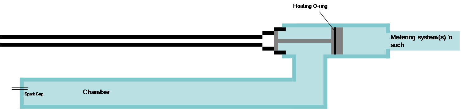

Thu May 27, 2010 6:59 pm
I know this isn't entirely relevant to the current discussion on the thread, but it is however relevant to the thread's purpose.
How well do you guys think this design would function?
irisher
Posts: 420
Joined: Mon Dec 29, 2008 2:53 am
Thu May 27, 2010 7:07 pm
The metering system would have to be purged before each shot and I think it might turn into a piston valve and vent your fuel/air.

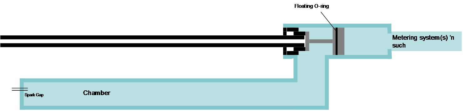

Thu May 27, 2010 8:27 pm
My take on the drawing is the outlet piston is IN THE FLOW PATH WHEN OPEN.
By using no o ring or drilling a small eq hole, it could be filled from the rear. Fuel first and then flush the pilot with air to bring it up to the desired mix.
Edit, edited the photo a couple times. Tell me if you like it.
Suggested modification.  Piston may retract mostly out of the flow when open.
Edited further to reduce the piston mass (low mass for speed) and permit the piston to further retract out of the flow path.
saefroch
Posts: 1679
Location: U.S.A.- See Map
Thu May 27, 2010 8:43 pm
Well no, it ought not to be. The floating o-ring should be open when filling, but upon venting the meter volume, it should move back and close. Thus, when the chamber mix is ignited, the piston should move back and open under the pressure increase from the chamber... opening the valve. Right? Or are you talking about the need to shorten the span between the front and back of the piston, to allow it to move back and not interrupt flow?
EDIT: Thanks for edited photo, I do like it, that design would work a lot better. I'll have to see if I could create something like that... the only issue for me is all I really have access to is NPT fittings, no welding tools here.
