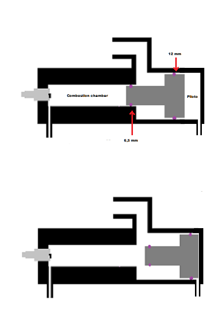

I have a small piston valve, and it seems to me that the piston area on the pilot side is too small, and therefore opens too early.
On the combustion chamber side, it is 6.5 mm in diameter and on the pilot side, 8 mm in diameter. the pressure of the hybrid is 8X. Do you think I can increase the area of the pilot's side more? up to how much diameter?
What is the ratio they use?
I have thought about increasing the diameter of the pilot side to 12 mm, keeping the 6.5 mm diameter of the piston pointing towards the combustion chamber constant. What do you think... :roll:

Actually the valve is like in the drawing.
I did some tests, with the piston ratio 6.5 mm - 8 mm, as it is at present, but, with different pressures in the combustion chamber and the pilot, and compared.
In the first case, it is 7 bar for the combustion chamber and 7 bar for the pilot. In the second case, it is 7 bar for the combustion chamber and 9 bar for the pilot, using a pressure regulator to obtain different pressures.
The energy has increased a lot ... tomorrow I will integrate a barrel with a bolt to compare the speeds of the ammunition.
The pending question is how much more can I increase the pressure in the pilot, keeping the pressure in the combustion chamber at 7 bar, or in other words, when the valve will not be able to open ...
I think that once I have obtained the data of the highest pressure that I can use in the pilot, having the combustion chamber pressure as constant, I will be able to deduce the force exerted by the pilot, and obtain a diameter of the piston on the pilot's side, to increase diameter and work with the same pressure on both sides. We will see. Thanks for your explanation.

Ah, so you're using a chamber/outlet sealing design. That makes more sense.
So are you trying to find the right sized piston so that you can use equal (before ignition) chamber and pilot pressures and still get opening at an optimal (higher) pressure?
If so you could probably play around with GasEq and use the formula: d = 2 * sqrt( ( P_c * A_c ) / ( P_p * pi() ) ), where:
  • d = piston diameter
  • P_c = desired cracking pressure
  • A_c = chamber area
  • P_p = pre-ignition pressure/pilot pressure
For instance using an 8 atm pre-ignition and pilot pressure and picking a completely arbitrary "target" cracking pressure of 75% of the maximum adiabatic combustion pressure (which is about 57 atm), I work it out to needing a ~17.4 mm piston.
All of this just a simple back-of-the-envelope approximation so take it for what it's worth. :P

oh yeah, I like your estimate. An exact approximation is not necessary, but in general terms, 8 mm is very small diameter. Therefore, I am going to remake the valve with a 16mm piston on the pilot side and 6.5mm on the combustion chamber side, to have more power. Thank you very much for your explanation for me. :)

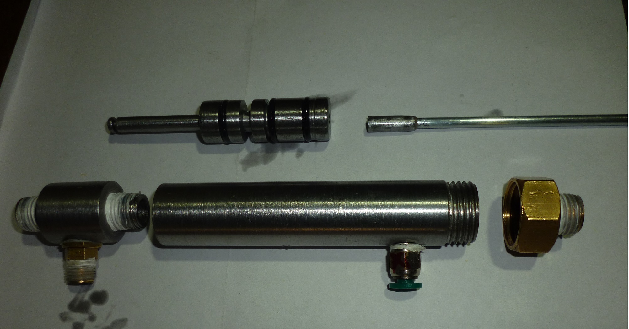

I built a new little 16mm piston on the pilot side and 6.5mm on the combustion chamber side.
I still have a pressure regulator sandwiched in the air supply going to the pilot area.
This is because the piston valve is a bit stiff and that force is in addition to that exerted by the pilot piston. The valve is working properly.

Here is a photo of the construction of
the 1045 steel valve. The larger piston includes the o'rings so that it is automatically depressurized
after each shot. All this works excellent, but the issue of the small o'ring breakage makes it unfeasible.

Here are the photos of how it is inside.

I understand what you tell me. Actually the small o'ring does not touch anything. It is built as in the drawing.
The o'ring fits into a 6.5 mm bronze tube with a conical mouthpiece and all well mirror polished, when moved to the left, (in the drawing), to seal the combustion chamber. When combustion occurs, and it moves to the right, it remains floating, so that the gases can pass towards the piston and accelerate the opening of the valve and let the hot air out through the gas outlet towards the firing barrel.
