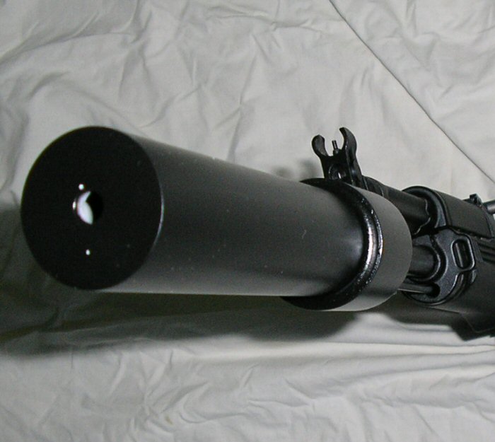

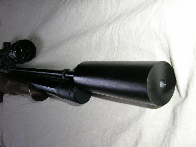

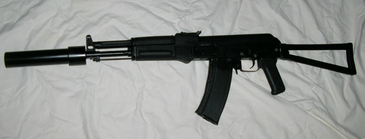

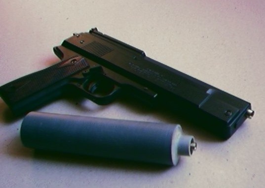

Here's a few I made for my airguns, they all have basically all work on the same principle as the diagram you made.
Yunker-2 suppressor
Yunker-2 suppressor
Yunker-2 suppressor, externally based on the PBS-1 suppressor used on the AK

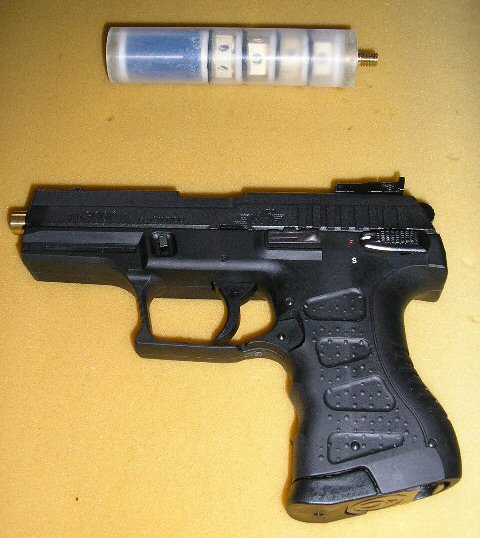

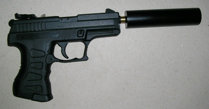

Anics A3000 suppressor construction - syringe tube body with foam/rubber baffles and drilled out lego blocks as separators, attached to the pistol with a custom made threaded adapter
The threaded portion of a pen was used to attach it to the pistol, with the female portion epoxied to the gun and the male attached to the suppressor

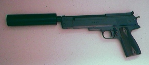

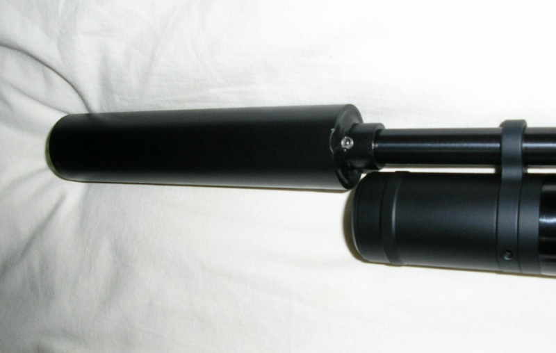

hw45sdproject (8).jpg (31.46 KiB) Viewed 8985 times
Weihrauch HW45 suppressor
Air Arms S410 suppressor version 2
Air Arms S410 suppressor version 1
