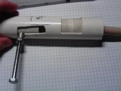

bolt parts
bolt parts

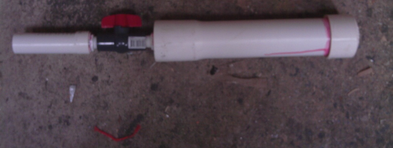

main chamber is huge, and the secondary chamber

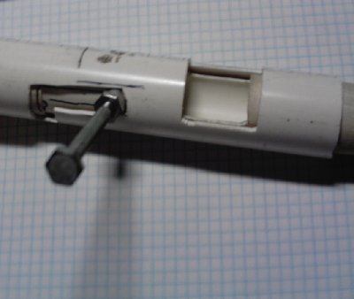

breech closed
breech closed
showing bolt open and handle
breech open
breech open
p chamber and s chamber with out second valve, with bolt below
