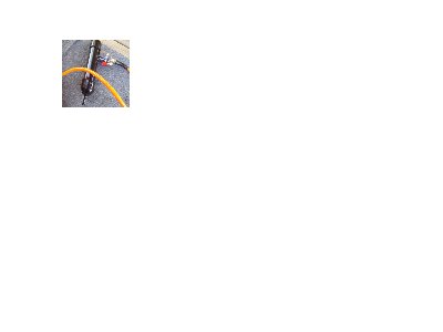

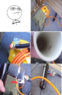

this is my homemade bbsmg it uses a 120 psi 5 gal tank and holds about 2,000 bbs. I still need to make a stock for it tho. 8)

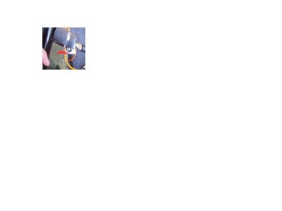

really soft foam grip thingy

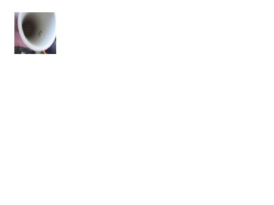

inside the chamber
inside the chamber

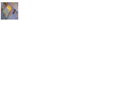

tank
tank
gun part and tank
gun part and tank
gun part
gun part

Looks good, but maybe some properly sized pictures would be nice. :wink:
How heavy is that air tank?
EDIT: and where did you get a 5 gallon tank? Smallest I've found is 7 gallon.
Sun Mar 27, 2011 6:20 pm
Nicely done but such a relatively large chamber can't be good for efficiency, have you thought of welcoming detents into your life?
A regged down paintball tank could probably give you the same firing time in a lot more compact package.
Why such a long hose?

i got the air tank at harbor freight tools its about 7 pounds and the hose is long because it was the shortest they had one in the store
