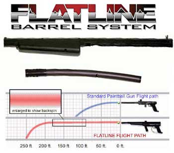

There is the possibility of a curved barrel such as the way a paintball flatline barrel works.jackssmirkingrevenge wrote:The challenge is a hop-up unit that will survive rates of fire
- The curved barrel puts a spin on the ball like a hop up, but without the durability issues.
- canon-flatline.jpg (15.17 KiB) Viewed 2901 times

With BBMGs it'll be more "accuracy by volume" compared to the very precise metering of air with a Polarstar - but once you have the velocity range should not be a problem once you get the hop-up sorted out. Ctulhu's suggestion for a curved barrel is a good one, it's a little harder to have it adjustable though since you need a different curve depending on velocity and BB weight.
