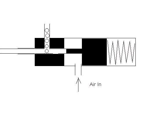

the pic shows how it can be done...
I suspect that there are two possible ways to do it... one of them is the one presented in the pic (note that the bolt has to move prior to the firing)
the other option is similar to the one in your pic but you'd have to make sure that the mag is blocked off when the gun fires...
you could either build it in a way that won't require the bolt to move to let air pass through or one where the bolt would have to retract slightly to pass air...
the latter would work better IMO as there would be more force that would help to overcome inertia of the bolt... with these designs ammo would be loaded after firing not prior to it
obviously with this mechanism you would have to either dry fire teh gun first to load ammo or build some sort of handle to load the first round before firing

Personally I think the blow forward bolt makes more sense, it probably takes less effort to operate and wastes much less air.

I could probably make those adjustments without too much trouble. I'm using 3 different sizes of tubing. The bolt is the smallest, 1/4", the tube it rides in is the largest, 5/16", and the barrel is in between, 9/32". The 9/32" tubing fits tightly over the 1/4" tubing so I can add on with a larger diameter and still have it ride inside the original 5/16" "T" tube. I just hope there isn't too much friction between the 9/32" tubing and the 5/16" tubing. They're both aluminum, so it shouldn't be too much I hope. They do fit very tightly though.
Jack, those would both be extremely easy to make, but I would either get full auto or bursts instead of semi auto.
Poland, I'm going to add on to the bolt as shown in the picture and do some testing to see if it works. Results in a few hours.
I got full auto because the valve was reciprocating, as you can see every blast of air fires only one projectile. The idea is that pressure pushes one projectile down the barrel and pushes the rest up the magazine. Unless your valve stays open for a long time, you'll only get one shot per valve opening.noname wrote:Jack, those would both be extremely easy to make, but I would either get full auto or bursts instead of semi auto.

I have to agree with JSR here that this is one of the best designs you can choose...
the tests I conducted long long time ago were rather dissatisfying but now I realize that was mostly a result of hasty construction and lack of proper materials
the design has some serious potential because it is as simple as it can be
give it a try...

The critical parameter is a tight fitting magazine tube, otherwise all the BBs will get pushed out throught the barrel at once as you've effectively created a cloud BBMG.POLAND_SPUD wrote:Now I realise that was mostly a result of hasty construction and lack of proper materials
