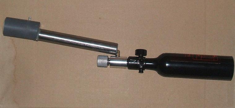

In the meantime, here's what version 3 looks like. Ignore the awkward angles and dimensions, this is just a prototype to determine performance. In practice I could make it a lot more compact, and it would have to include a ball valve of some description to be included in a trigger mechanism. Originally it was just the grey valve portion but I've now added a section of stainless tubing as a chamber, to be tested later today :)

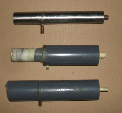

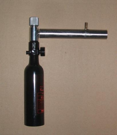

Sat Apr 18, 2009 2:12 pm
Some pictures of the latest version, can't wait to try it out:
The evolution, from bottom to top it's versions 1 to 3
auto valve v3 hooked up to the tank
Lentamentalisk
Posts: 1202
Location: Berkeley C.A.
Sat Apr 18, 2009 3:06 pm
Oh god that is beautiful. Honestly, that is looking amazingly close to professional now. Nothing says "well built" like a shiny piece of steel pipe :)
