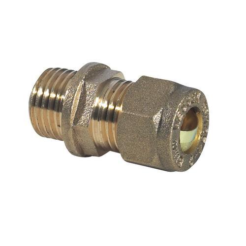

But I love your gun design and I joined this site hoping someone can help as I am building my own based on your design.
My main problem is the barrel. How is the barrel attached to the blowgun?
Also, just by looking at it, I have guessed the other items I need. I just need confirmation and info on anything I may have missed or gotten wrong.

hi
mayby this cind coupling
1/4 to blowgun and 8mm OD barrel
