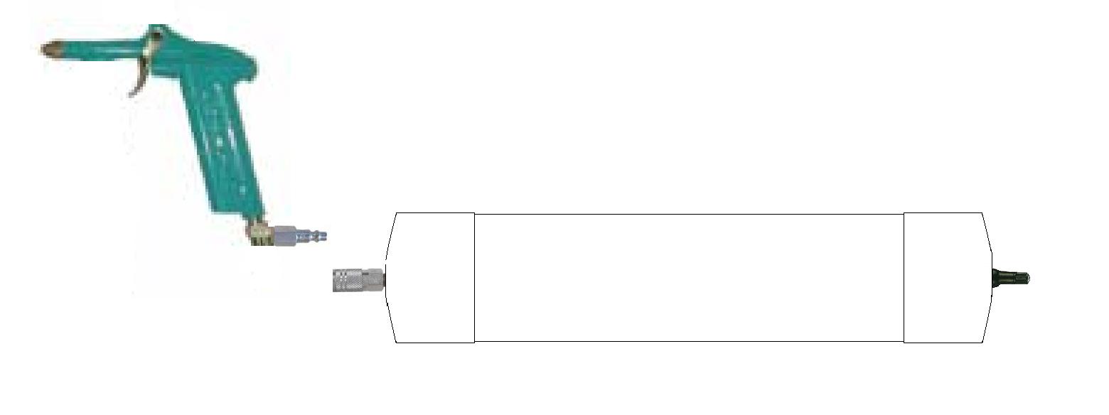

i just drew/photochopped a picture of compressor fittings, and using microsoft paint to show what i mean... give me a sec to upload
EDIT: heres the ms paint/photochopping idea.
Quick draw up, nothing special
BLAH BLAH BALH.jpg (29.7 KiB) Viewed 6729 times

Thrusto... is that a quick release valve attached to the blow gun diagram? sorry for noob questions XS.

littlebro05 wrote:Thrusto... is that a quick release valve attached to the blow gun diagram? sorry for noob questions XS.
I'd use co2 but thats expensive here in australia, air is for free :D.
Yes, on the bowgun is the male connector, and on the chamber that is a female quick release, with the male piece is taken out via a push on the famle button and a pull, it auto shuts of so no air escapes.
Do you have any idea how much the male and female connectors cost? because if it costs more then like 5 bucks (i'm asian i'm cheap hehehe), then i'm not going to use it...

well i was at bunnings about 2 hours ago and what not :roll: couldnt resist myself :D
but your going be dissapointed, female connectors are like $8 each (you need a few of them if your having a few detachables)
and the male piece is like $5 only need one of those, which goes onto the bottem of the blow gun.
its totaly worth it, im going to use this idea on an up coming semi/bolt action auto bb rifle design.
