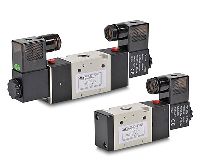

yours is a direct acting one - so the solenoid has to retract the plunger to switch the valve
but there are also indirect acting valves that essentially have a small inbuilt valve just like yours but that valve is merely used to pilot the spool
Essentially it works like this>>>
don't worry it's fairly easy to identify one
Indirect acting valves look like these:
Direct acting valves look like this one:
Even a 1/8" indirect acting valve would be enough for an airsoft gun but 1/4" would give more power

so would this be an indirect acting one?
Yes. But as far as I can tell it looks like a cheapo chinease valve... one that's seriously overpriced I mean... also try to find a normally open valve
here is what I'm trying to do
yeah it will work
what about manually activated ones
there are indirect acting manual valves but the one you posted is not
Indirect valves have a little triangle shape right next to the actuator

only if it was a universal valve - but most indirect acting solenoid valves are not universal - they are either NO or NC
If you're wondering why then have a look at this pic again
See that tiny passage from the P (marked as 'in' in the pic) to the solenoid itself ??
if you connect your air source to a different port it won't work - indirect acting valves need pressure to operate

Oh, now I see. The valve you posted has 5 ports, I was thinking about 3 port 3 way valves.
For the valve that you posted, the chamber would be attached to the port between "In" and "Idle output", and the barrel attached to the right most port, right?
oh, and can I block off the other two unused port with a plug?
Fri Feb 10, 2012 11:43 am
3 way indirect acting valves work in the same way
yes, that's exactly how it would work
