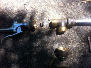

Should the piton protrude into the chamber behind it ? If you can see here there is a gap from on chamber to the next!

Should the piston protrude into the chamber behind it ? If you can see here there is a gap from on chamber to the next!
Re: First QEV,need piston help
Posted: Wed Nov 06, 2013 5:55 am
by jackssmirkingrevenge
Looks OK to me.
Posted: Wed Nov 06, 2013 6:49 am
by andrew67
Thankyou! I'll finish it off tonight and see how it goes!
Posted: Wed Nov 06, 2013 7:02 am
One thing, is the face where the piston touches rough with sharp edges? This can compromise sealing and damage your piston seal.
Posted: Thu Nov 07, 2013 1:25 am
by andrew67
Nah,no sharp edges I've filed the barrel flat with a fine file and taken the rough edge off,I'm using a nylon washer as a seal,that should be ok yeah?
Posted: Thu Nov 07, 2013 3:11 am
by Labtecpower
I don't think filing the barrel flat will do, especially with hard seals like yours. With a nylon seal the barrel needs to be absolutely straight, as there's not much deformation on the seal to close gaps. You'll have better luck with a rubber washer.

Ok,thanks i think I'll just use rubber to save pulling it apart again,do you glue the spring to the piston or is it ok without glueing?i think I've asked just about everything I can think of to get it right first time!thanks for all help!
