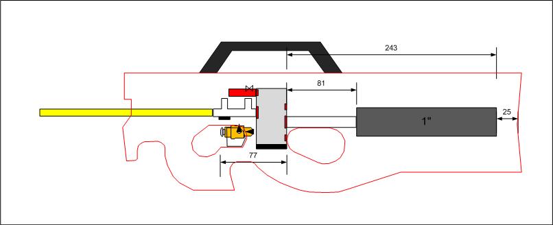

This may take some time to complete so I am going to take pictures of the progress. P90 style BB gun, maybe full auto or burst fire, depends how it works, or maybe not at all.
- BB 2.jpg (23.91 KiB) Viewed 6476 times
Cut out the rough body shape from 3/4" plywood. Will be in two halves screwed together.

Been working on a block of aluminium I found, it houses a cylinder which will block the BB's when fired, it will be a 4 shot burst if it works
1" stainless steel chamber finished as well.
