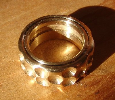

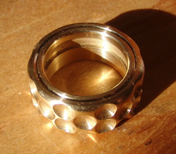

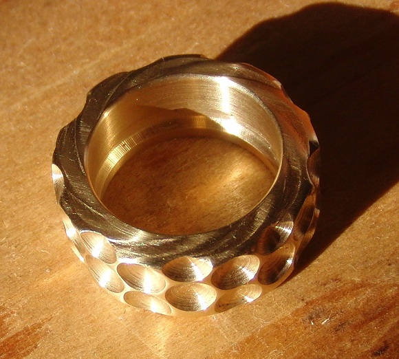

I took the Mk.2 collar and some more turning and polishing later, voila. Merry Christmas darling, I'm an awful human being :)
