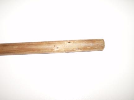

Now with the dowel i used 4 nails they where 20mm small tacking nails.and i set them as to cross through the dowel on four different points as to make a + through the dowel and only have about 1-2mm of nailhead showing this is why you use a tight fitting dowel,and i off set each nail about 15mm from each other along the dowel length wize as not to crack the dowel and so the nails dont hit each other but trying to get the nails to go in straight,that was a fun i can tell you.then it was up to my trusty dremel grinder to grind back the protruding end of the nail(not the head).Now first thing to do is to test it on a small section of same size pipe as not to ruin your good barrel and test it,you may need to do some fine tuneing to the nails head with a dremmel to set the depth not to deep and also to make it easer to pull through

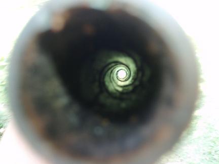

- This si my 3/4 rifled barrel i did it myself :P
- pic101.JPG (10.25 KiB) Viewed 9612 times
- This is my rifleing tool i use to rifle small barrels
- pic102.JPG (5.87 KiB) Viewed 9611 times

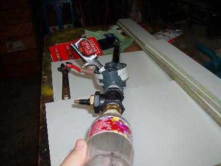

- this si the cannon my rifled barrel is used on,i have only been able to fire carrot slugs and such due to that painballs are expenisve and hard 2 were i live in australia
- pic103.JPG (19.1 KiB) Viewed 9610 times

The twist rate is surprisingly consistent... surely you didn't do that compleatly by hand.
Could we get a description/pictures of your setup?

Glad to help, anywho, the I have to agree with BLB, the twist rate is suprisingly consistint, I might have to give this a try. A carrot slugger sound like fun.
Holy Sh*t!
Either you got the steadiest hand on this side of the Mississippi, or you didnt use your hand... Sorry for the third echo, but how did you do this??? (This post doesnt state anything new, only for adding to the urgentness.)
Ahhhhhh that is mad!how did you do it so steadily?????i thik im gunna rifle my 1/2inch barrel now.
