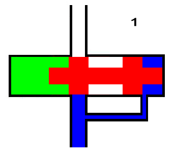

Looking at it closer I think this is how it works. I've dropped the spring completely and that little port into the barrel and am using air as a spring.
Blue is high pressure air, green is lower pressure air and if it's white it's at normal atmospheric pressure.
1 high pressure air enters the system
2 piston pushed across, opening valve
3 high pressure air is free to flow down barrel
4 pressure decreases and system resets
Well I think that's how it works.

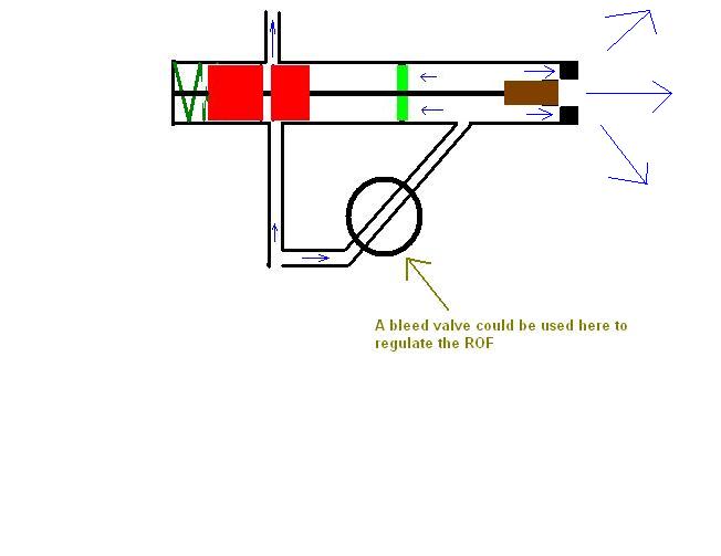

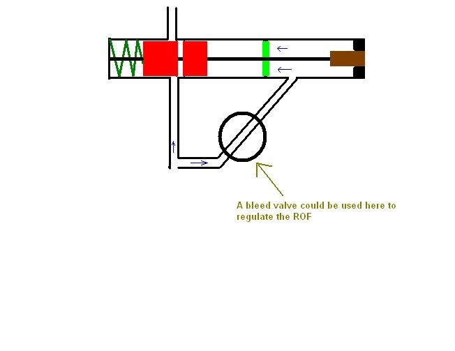

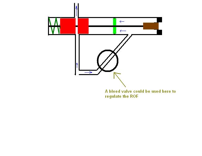

JSR that drawing sucks so don't bother looking at it, you know it was late at night and it was a wrong interpretation of that diagram that I've found in the documentation of that valves.....
this is much better and it would work for sure.... you could also use a free floting idea for that brown piston in these pictures.. i think it would improve the whole thing.... the real problem is that it would waste some air.....
- third phase... air is let throught that opening (brown piston) and the spring moves the whole valve to the right blocking the flow to the chamber... possibly wthe brown piston could be free fpoating to give more time before the valve opens... or the realesed air could be used to power an air cylinder that would help the spring to close the valve and would give more delay before it opens again.... but this makes everything more complex and it is needed to realese air from the aircylinder afterwards...

- second phase... air is let to the barrel the piston is still moving to the left
- XZ1.JPG (19.31 KiB) Viewed 3581 times
- first phase... air is slowly moving the piston to the open position
- XZ.jpg (18.71 KiB) Viewed 3581 times

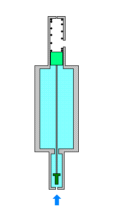

I've found some off the shelf parts that are used to provide pulsed air.... it generates 5 Hz pulses of air (so a pulse every 0.2 second) (sorry but expressing this is very difficult if your not a native speaker of english )
It is interesting becasue you can also regulate how many times per second pulses are generated
some pics and a diagram that I think might be very useful for you
The pics and diagram are intriguing, but a brand and part number and source would excite me much more! Do tell!

Agreed, but I doubt such a valve would have sufficient flow for our applications.The pics and diagram are intriguing, but a brand and part number and source would excite me much more! Do tell!
