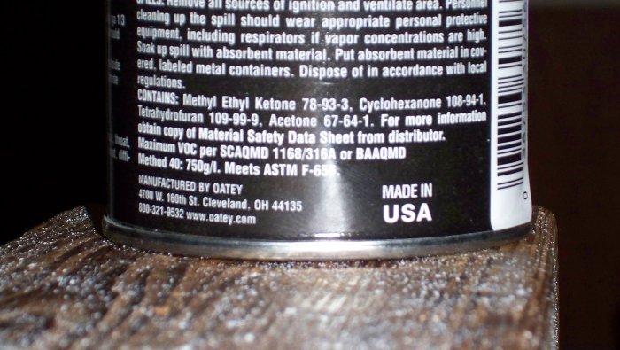

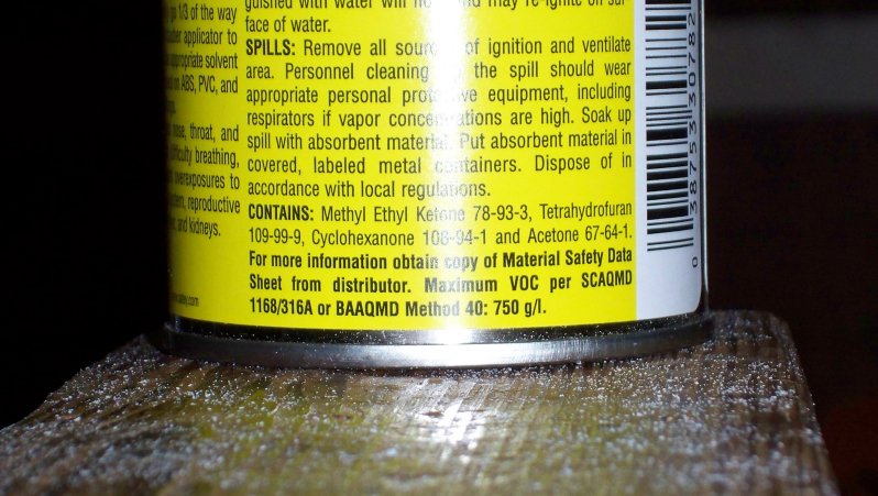

In my exhaustive search for clear PVC primer a few months back, I was being frustrated at every corner trying to find a local supplier. No one seemed to have it...I don't live in a backwoods town...I couldn't figure out why the stuff was so hard to find.
Anyway, I finally went to the local plumbing wholesaler in town...supply's all the big construction jobs in the area....and talked to the counter guy about it. He casually walked to his shelf and brought out a can of Oatey Cleaner....the stuff in the yellow can. I asked "Are you sure that's primer?" Him and couple of the old salts hanging around the counter laughed and said "Yep".
Anyway, it's hard to get Oatey to admit it but it is a real primer...apparently since building codes almost world wide require primer to be dyed. However for decorative uses (and spud cannons) the Oatey Cleaner does exactly the same job. It cleans and softens the PVC just like the purple stuff. I've been using it on all my PVC welds with great success. The contents on the side of the cans verify the active ingredients in each, they are identical!! ...minus the purple dye of course.
Give it a whirl, I think you'll see it works just as well.

Hmmm, it's interesting that their labels list the same ingredients, but the MSDS for cleaner doesn't list Tetrahydrofuran or Cyclohexanone. Anyone got any ideas why the MSDS wouldn't list them (it does on the clear primer MSDS).
The guys at the local plumbing supply around here told me SCH80 didn't exist above 3/4" :roll: . Personally I wouldn't go solely on their word.
IMO it's not worth the risk of maybe being the same thing, but to each his own.

clide wrote:Hmmm, it's interesting that their labels list the same ingredients, but the MSDS for cleaner doesn't list Tetrahydrofuran or Cyclohexanone. Anyone got any ideas why the MSDS wouldn't list them (it does on the clear primer MSDS).
Yes I looked up the MSDS as well. Not sure why they wouldn't list all the contents, possibly an older formulation listed there.
It is however, the same. Try a can on some test joints for yourself...same smell, same action, same softening, same nice strong joints... I'm convinced they don't come close to the "primer" word because of the dye requirement in building code and possible legal liability.
Also, while Oatey describes their "Clear Primer" (brown can like the standard cement) product on their website, I have yet to find anyone that actually sells it.
