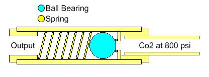

The reason i'm asking is because i was wondering if this would work to regulate co2. Beacause if i remember properly, in a tank, co2 pretty much stays at 800 psi until its empty...
co2 regulator
co2 regulator
co2 regulator.JPG (12.96 KiB) Viewed 3990 times

That is Basically a Regulator, Except for the fact you need a VERY STRONG spring.........
In fact, that IS a regulator. Congrats.

Well, its a co2 regulator.
This wouldn't work with air since the pressure in the tank drops unlike with co2. Right?

Ragnarok
Posts: 5401
Location: The UK
Wed Nov 05, 2008 8:23 am
VH_man wrote:In fact, that IS a regulator. Congrats.
Sorry, this is not a regulator:
It's a check valve, and all it will do is let CO2 through from right to left until the pressure is the same on both sides.
Well, to be more specific, it will let CO2 through until the force on the ball is the same on both sides. What it will actually do is create a fixed pressure difference between the 2 sides.
As CO2's storage pressure is reasonably fixed, it would very crudely regulate CO2, but it cannot be called a regulator.
If you want an idea of how a regulator works, this animation of mine gives the crude basics:
The spring has to be the opening force - not the closing one. It also has to be opposed to the regulated side, not the high pressure one.
In this case, the high pressure side has no impact on the opening force.
