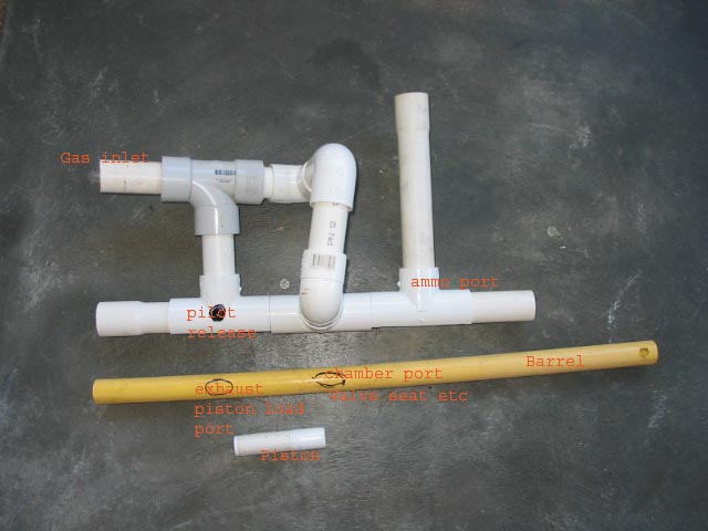

I was wondering if anyone has made a similar item before? would it work and would it be good?
Just a dodgy replica model I made up, to make a working model I would need a lathe and some tooling which I don't have...material would be pvc or copper sleeve for external "plumbing" purposes and and a heavier  metal internal sleeve and barrel would have to be a perfect fit to turn and not leak gas excessively.
While what I display is single chamber which would be easier to build and carry around, such a design would yield a faster firing rate with a separate pilot/chamber plumbing on the "spare" 180 degrees of travel.
Operation would have the barrel turn and first charge up the pilot area pushing the piston forward, then the firing chamber would shortly line up and then as chamber is lining up pilot fill port closes and pilot exhaust opens, the ammo port would pick up at the same time as the pilot fill.
None of this model is close to scale but I hope youse get the idea of the design I had in mind.
							Rotary barrel, multi chamber launcher idea
Too many uncertain seals going on for my taste.
It is possible to have rotating seals like that - look at ball valves - but it'll take a lot of work.
In fact keeping on that note, because this is being rotated to open the valve ports I have serious doubts whether it will perform any better than a ball valve cannon.
I'd think quite a bit before investing in it.
