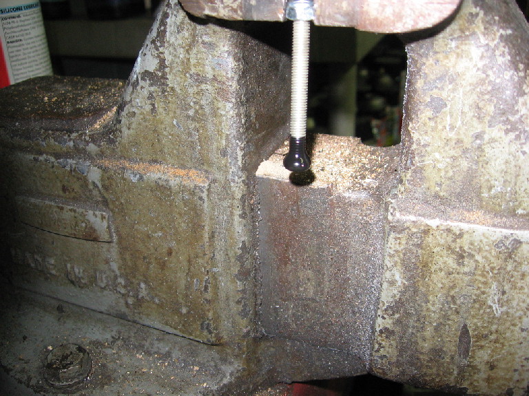

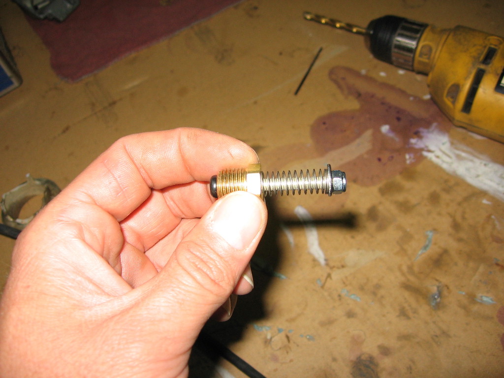

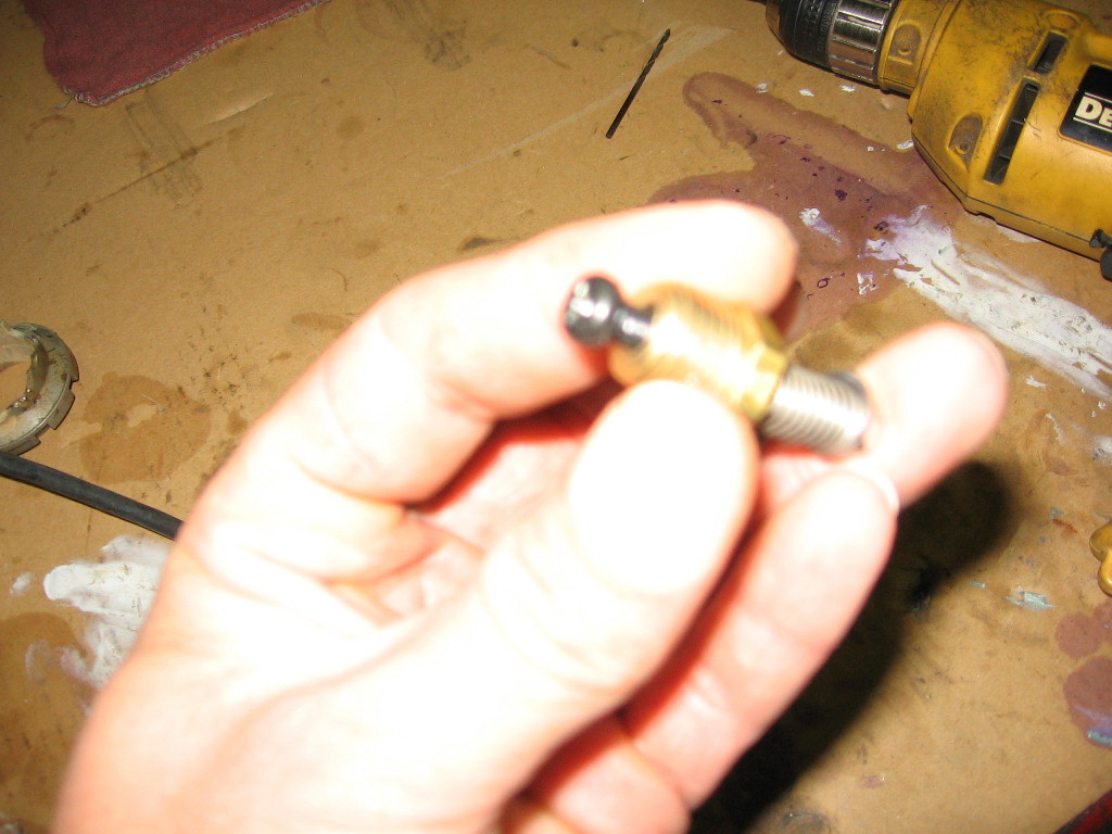

Yesterday, I was playing with my new copper gun, and wasn't real thrilled about the performance at lower pressures(80-125psi), not sure if pilot volume is marginally large,the piston is tight, the return spring piston, or if the schrader I was using wasn't venting quick enough...
So I said to myself, " Self, why don't you make a larger better flowing schrader?"....
Here's what I came up with...

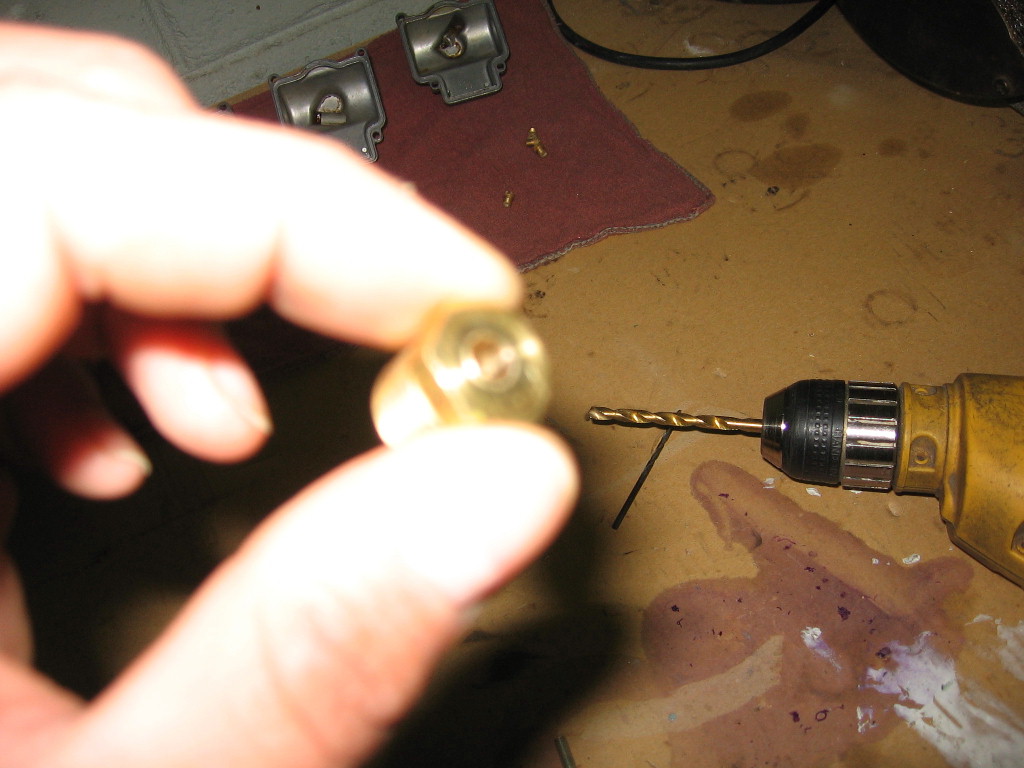

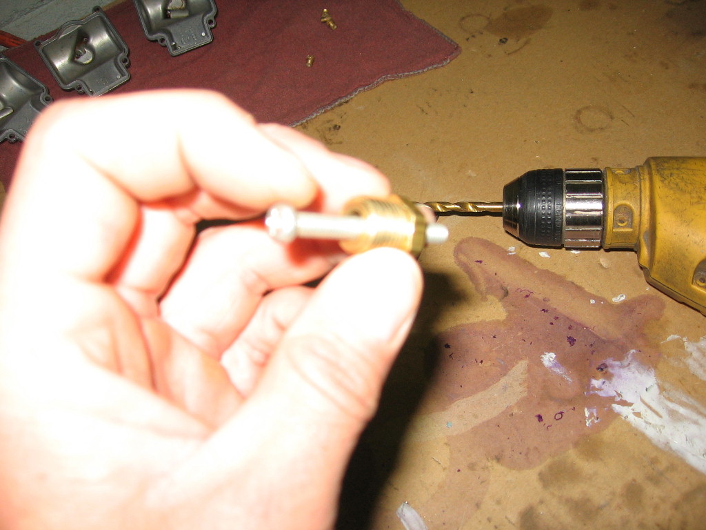

1. Take a 1/4"npt brass plug.
2. drill a 7/32" hole through the plug.
3. take a 5mm x 35mm panhead screw.
4. dip the head in plastidip until you cover the head and the first 3 threads, about 3 coats.
5. insert the screw from the inside going out.
6. take a small coil type spring and put around the exposed screw.
7. put a 5mm nylock not on the screw(to retain the spring and apply sealing pressure) until the screw and nut are flush.
voila, you have a larger venting valve that is push button operated, is no larger than a standard screw in schrader, and so far I've fired it 40 times with 125psi, and 12 times with 275psi, and no sign of damage to the sealing face...
Performance is AWESOME, when you press the button the gun nows goes "POP" instead of "pfoomp"...
If you're not clear on anything, just ask...
