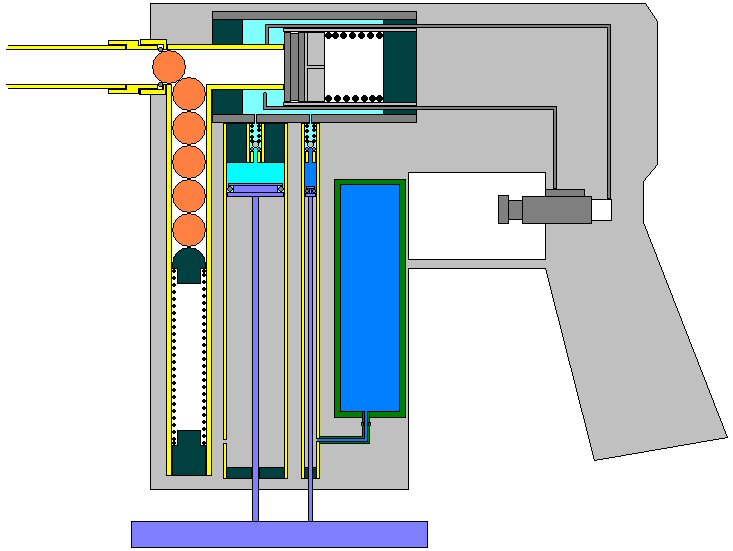

I made a diagram of how I would build a hybrid with an on-board fuel supply and integrated pump, it seems like it's feasible but the thought of getting cartridges to work reliably sounds more appealing now

Why not use a wood nailer/tacker as a base?
That would give you fuelcells, the right mixture etc.

hmm... there is a detent, but why it isn't the main valve ??
ohh consider loading ammo from behind

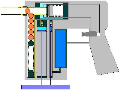

- this should work... you might even turn it into a coaxial... ignore the air cylinder and that automated metering stuff
- automated hybrid.PNG (32.78 KiB) Viewed 5977 times
Adding the piston reduces stress on the magazine, something you avoid by adding a separate bolt.POLAND_SPUD wrote:hmm... there is a detent, but why it isn't the main valve?
My usual choicePOLAND_SPUD wrote:from behind
As I said though, I probably won't be trying to make this. Just wanted to sketch out what's needed to see if it would be practical.

Not if the gun is loadedAdding the piston reduces stress on the magazine, something you avoid by adding a separate bolt.
from behind
Basically this with the blowgun replaced by fuel+air+spark?

yeah

Flooding the chamber with fuel and filling to a fixed air pressure certainly makes charging simpler, but you're going to need to add an on-board precisely regulated HPA tank for multiple shots as well as the fuel reservoir, so in short the final result will be at least the size of an assault rifle.POLAND_SPUD wrote:yeah
and it might work well with this idea
What I was after with this design was something small and compact that could be refilled with a single stroke, certainly it won't be the most powerful launcher. Changing the geometry and upping the calibre could give you more muzzle energu on a pump-action shotgun style package.

not necessarily... a typical lighter should be able to provide enough fuel for at least 15 shots, maybe morebut you're going to need to add an on-board precisely regulated HPA tank for multiple shots as well as the fuel reservoir
who said you need a HPA setup ? put a pump on teh gun and check how many strokes you need to reach the ideal mix
not what I am after but it is certainly an option

Looks tricky, but build-able, I like it, especially the double-pump-metering-system.
But I see two problems and one idea for improvement:
- Due to the fact, that one pump-piston will have a much larger surface, there will be a torsional moment at the point where the (larger-) pump-shaft meets the pump-handle. The whole construction would have to be very rigid...
-You would most probably have to add a little chute in the barrel, to avoid the balls from being pushed in the wrong direction (leading to multi-feeding...)
I would recommend furthermore, that you change the position of the fuel-line to the pump and add a check-valve , because otherwise you would have to seal the shaft of the smaller pump.

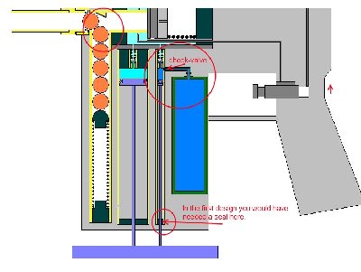

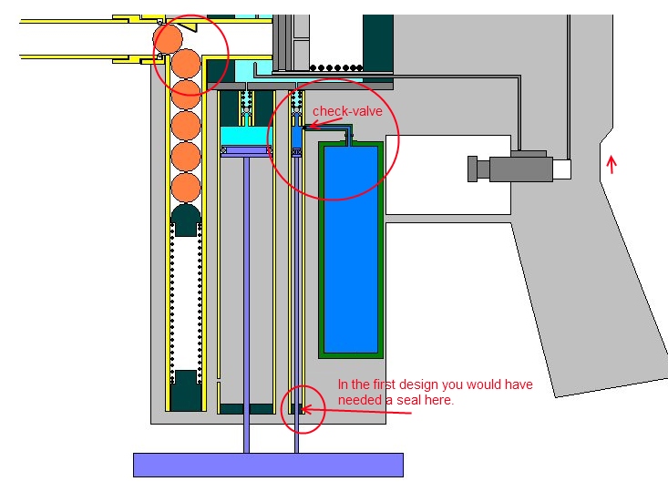

I added my thoughts to the diagram:
Edit: Don't ask me why there is a small red arrow on the right. I don't know.

Exactly what I had in mind as a fuel sourcePOLAND_SPUD wrote:a typical lighter should be able to provide enough fuel for at least 15 shots, maybe more
I'd rather have *click-click* bang as opposed to *click-click-click-click-click-click-click-click* bangwho said you need a HPA setup ? put a pump on teh gun and check how many strokes you need to reach the ideal mix
Moar epoxyDue to the fact, that one pump-piston will have a much larger surface, there will be a torsional moment at the point where the (larger-) pump-shaft meets the pump-handle. The whole construction would have to be very rigid...
I didn't include it in the diagram but in practice a smaller diameter insert would be there to prevent backward feeding.
The problem with your solution is that the dual piston mixing relies on the fuel being at atmospheric pressure, but it's stored at higher pressure in the reservoir.I would recommend furthermore, that you change the position of the fuel-line to the pump and add a check-valve , because otherwise you would have to seal the shaft of the smaller pump.

right, but there is nothing to block the flow of fuel to the chamber...I would recommend furthermore, that you change the position of the fuel-line to the pump and add a check-valve , because otherwise you would have to seal the shaft of the smaller pump
though if you think of it you might as well get rid of the fuel pump
