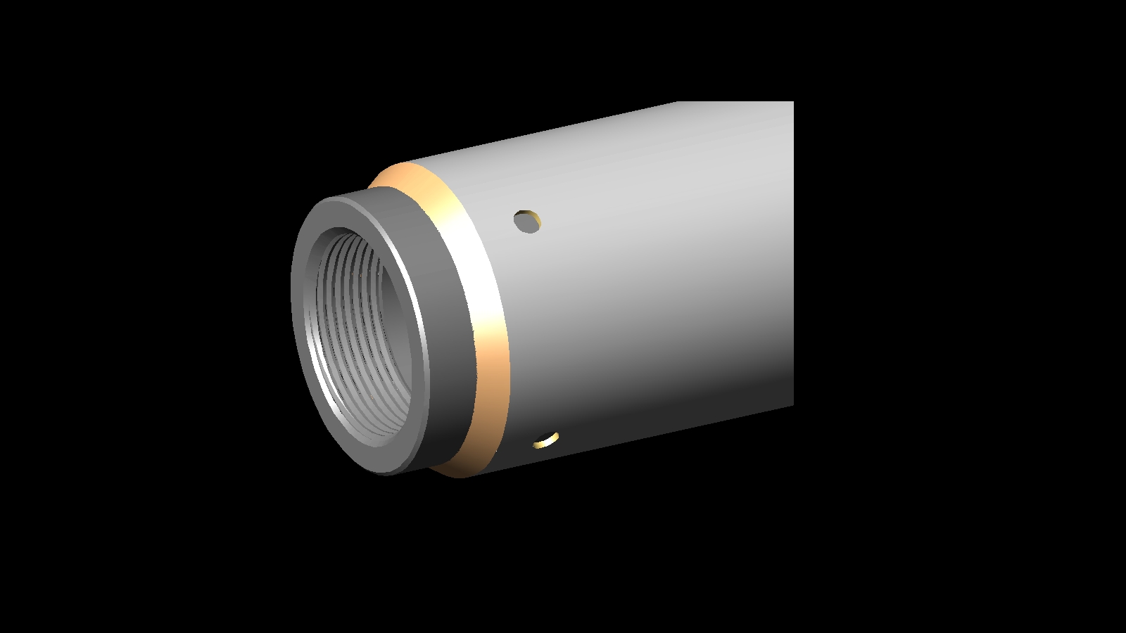

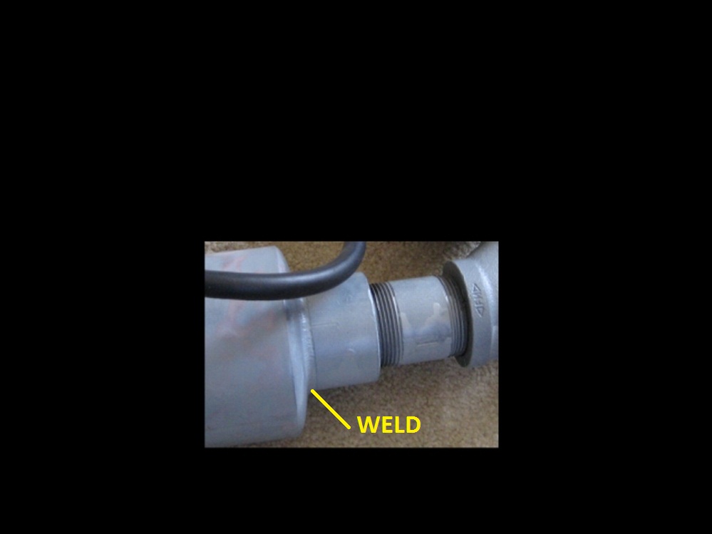

What does everyone think about welding a 2"x1.5" iron reducer inside a steel barrel to get 1.5" threads by either grinding down the 73mm area to match the ~68mm part or cutting it off. The inside diameter of the barrel is 68.5mm.
I'll have to grind down the lines that run vertically down the 68mm bit as well as any raised writing on the fitting.

Crowley: That would work fine, but with that much surface area to work with you could solder it in yourself, if you'd otherwise have to pay to get it welded. Just make sure to grind off all the galv. Thoroughly flux and tin both parts before doing the actual joining. I made a 1.5" barrel for my old hybrid this way, and it came out pretty nice (it's shown in the thread now).

Thanks for the tips. I don't have any flux or solder and it seemed pretty expensive last time I saw it at the hardware store so I might just see if I can get it welded for $20-$30 like my current S/S barrel.

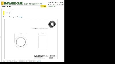

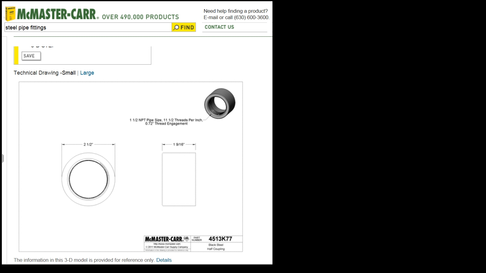

I recommend using a half coupling also known as merchant coupling.MrCrowley wrote:What does everyone think about welding a 2"x1.5" iron reducer inside a steel barrel to get 1.5" threads by either grinding down the 73mm area to match the ~68mm part or cutting it off. The inside diameter of the barrel is 68.5mm.
Much easier to weld and it is steel not black iron.
The holes in barrel are for weld fills for extra support. (optional)

Thanks for that, I was actually wondering about drilling holes for weld fills but wasn't sure if it would do more harm than good. I think I know a place that sells those steel couplings as well, but they're only open on the weekdays so it can be a bit difficult getting out there with uni going on.

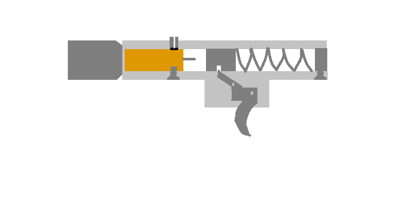

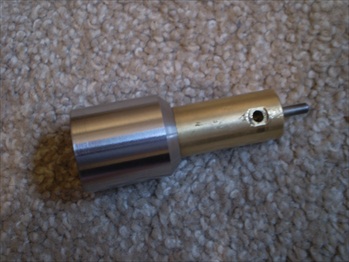

Looking for some thick wall Aluminium tube for my new PCP, it needs to be able to fit a crosman 2250 valve inside it, I have narrowed it down to This The Crosman valve is about 18.6mm in diameter. Do you think this would be any good? if it leaked i could turn an internal O-ring groove
- Custom Paintball tank adapter for Crosman valve
- P1011086.JPG (35.14 KiB) Viewed 3842 times
Where's my Chuck key?
How were you planning on attaching it? Unless you epoxy it in place you'll need o-rngs even if it's a perfect fit.

Theres a threaded hole for a mounting screw opposite the exhaust port on the valve im just gonna use an M3 CSK bolt, Machining isn't a problem as i now have weekly access to a Hurco TM10 and a VMX64T, i have a Solidworks model on my other Laptop but only have a 2min Mspaint bodgejackssmirkingrevenge wrote:How were you planning on attaching it? Unless you epoxy it in place you'll need o-rngs even if it's a perfect fit.
