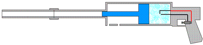

PeteS wrote:It doesn't sound all that complicated to me, but maybe I am missing something. One likely advantage I can see is that it could be used with no pump, powered purely by combustion. That way you would not be tied to an electrical power source. You would only need the launcher, some spuds, some burst disks, and your propane metering system. So only a few pounds of stuff that would all fit in a small backpack.
There has been some discussion of such systems, here's a diagram I had posted a long time ago:
No real advantage in using it as-is though, for real advantage you would need the piston on the compression side to be of smaller diameter in order to generate significantly larger pressures than what the combustion is achieving.
That being said, I'm sure there's room in your backpack for a small bicycle pump - go hybrid, you won't look back!

Hybrid indeed may be the way to go, but it seems to me this would be pretty simple and work. The line in the barrel a burst disk
