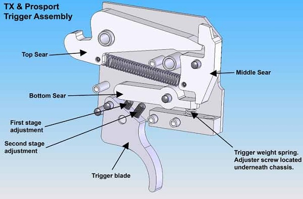

On the subject of friction being a problem with opening, this issue is solved in some machines with a huge amount of friction, for example, ye olde crossbows simply by having a long trigger which gives a lever advantage against the friction from an immensely strong bow, I'm wondering if the same could be done here.
Another option would be to have the locking piece pivot instead of slide into place, meaning when unlocked it would just be pushed aside by the projectile rather than have to slide out of the way.
That would definitely be a solution, a perfect mechanism to imitate would be the trigger of a spring airgun:
