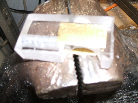

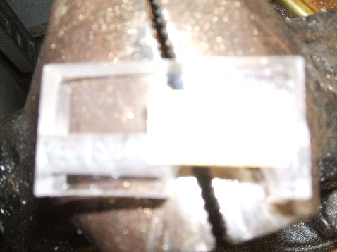

This is a guide to making an inline vortex block. My mini SMG should be done within 2 weeks, now that I have a compressor to use it. I was going to make the block today and thought I might as well show you guys how.
It should only take 20 minutes to half an hour to make one.

Thin walled metal pipe, 1/8" sheet PVC, or something else very strong, flat, and thin.
1/2" to 7/8" sheet PVC, acrylic, ABS, hardwood, etc.

EDIT: i was actually thinking of making a vortex block but i thought that you used a full circle like the one that the wiki links to not a half one like you are showing is there a difference in performance

In "regular" blocks with full circles, the BBs can circle around multiple times, therefore wasting air and lowering the ROF. They also have to travel further with a full circle, so this uses even more extra energy.
You use a screw or two, if you want it to be detachable (you do!) for maintenance. You can use epoxy if you want, but there's no repairing/replacing if it gets worn down or shatters, or something bad happens in general.
