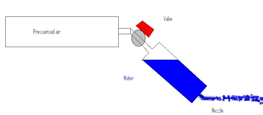

about point
3a. if i dont put it at the exhuast where should i put it in order to release the water+air mixture?
b)i m thinking of making a longer wooden lever to reach the valve at the back actually.
and i am going to use class E upvc pipes. its rated to 15bar or 217psi. suppose i use a 1" nozzle.. what kind of mixture should i use? sry boilingleadbath but i was never good in maths and i dont understand the stuff u just posted.. could u do me a huge favour by calculating what kind of water/air mixture i would need with the same dimensions as the one posted above?
I think a setup like this would work best:
- This is not to scale
- water rocket propusion.JPG (20.49 KiB) Viewed 4706 times
