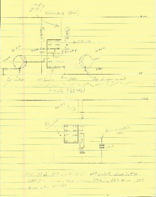

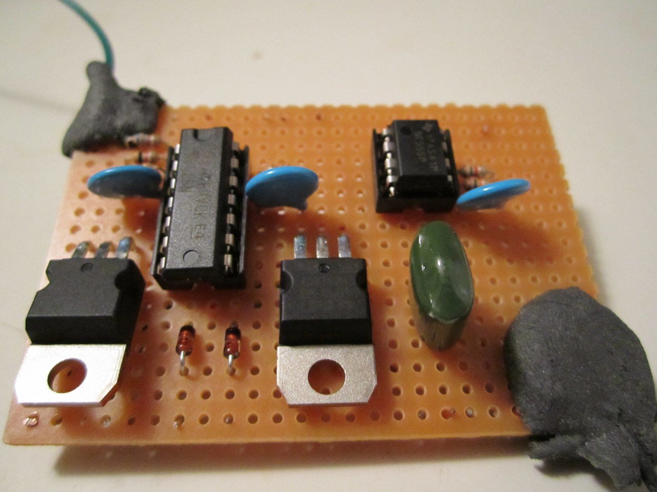

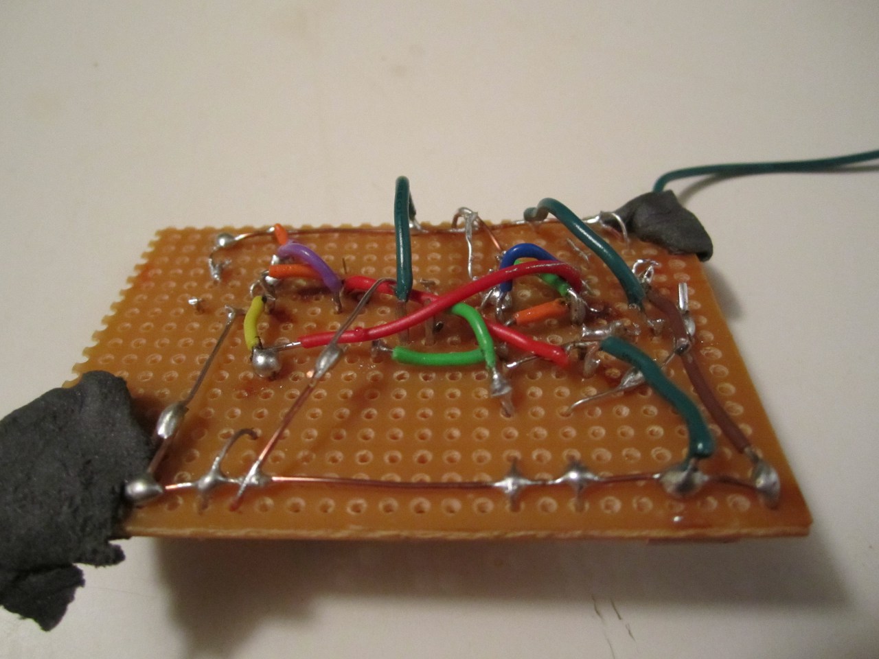

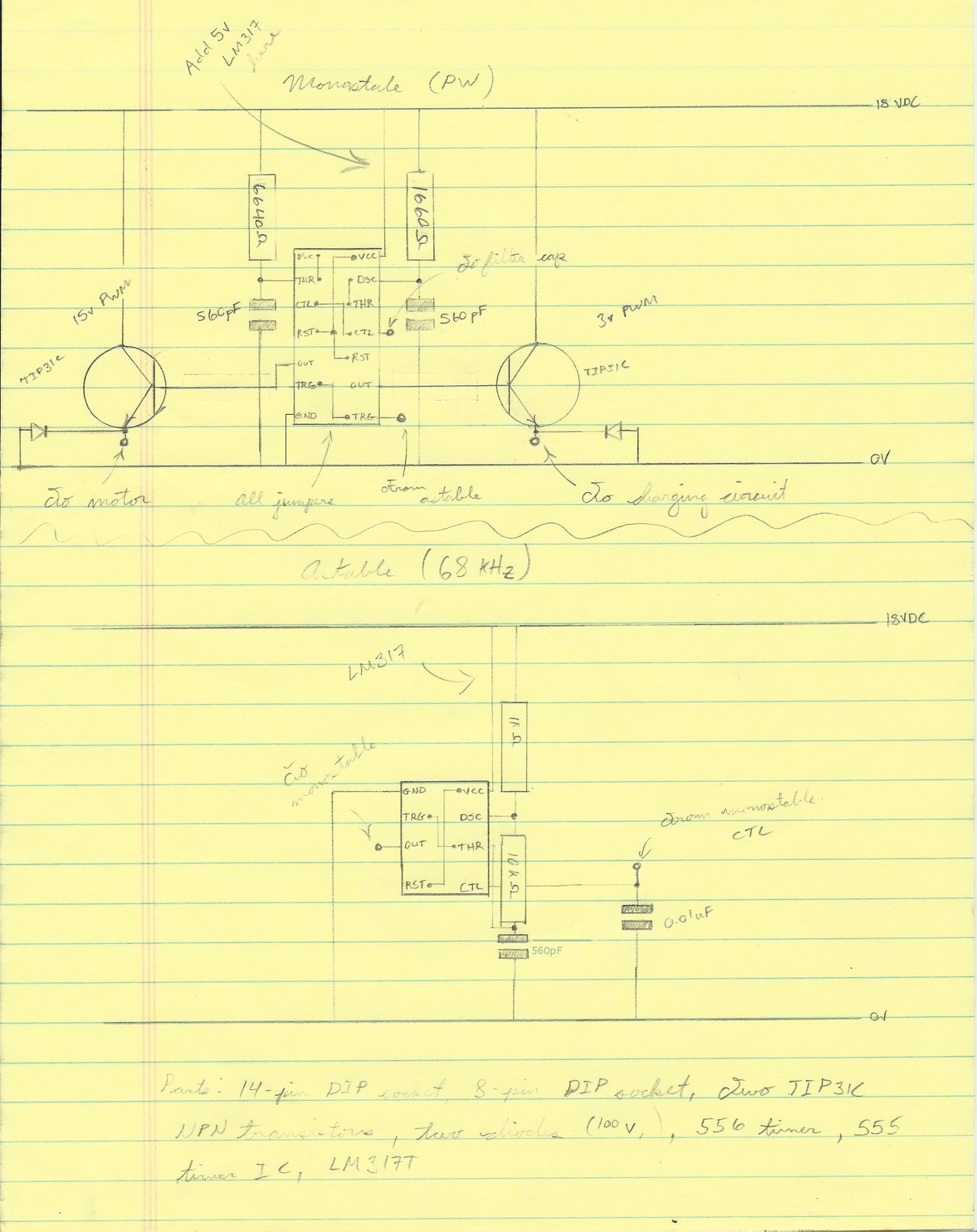

Hmm.... how much are those PCB companies charging these days?
EDIT: and unsurprisingly, it doesn't work. I double checked my wiring, though, and I think the likely culprit is that I fried the power switching transistors with my 75-watt howitzer/soldering iron.
It was supposed to be a PWM circuit with a 12 and 3VDC output, but all I can measure at the emitters of the switching transistors is 0v.

mark;
I do see some problem areas.
What are you trying to achieve with this circuit design?
A DC motor control and 3 VDC charger?
Why such a high Astable frequency? 68KHz
What kind of motor?
What kind of motor?

It's basically just to provide two switched power sources without ohmic losses as involved with linear regulators. This is sort of a "proof of concept" circuit.
I suppose I could go lower with the frequency. 68kHz is just one of the "standard" 555 frequencies (made with a 1kohm, 10kohm, and 0.001uF capacitor).
The motor is brushless.
