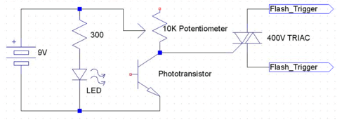

Insomniac wrote:I've decided that I won't worry about the flash speed at the moment, and insead find a way to trigger it based on sound. Some circuits, such as the Make homemade strobe photography circuit seem a bit complex and expensive. Further googling found me THIS.
If the comments are to be believed it will cost about $10 to make (probably a bit more but hopefully not by too much) It doesn't have delay controls, although this isn't too important to me.
What I need to know (hopefully you understand electronics well enough to figure this out) is just how many volts it can take across the flash trigger. Will it be fine directly connected to the 60+ V the disposable's trigger uses, or will I need to use an SCR to make a low voltage trigger, and the connect that to it instead?
The output triac in the linked circuit is rated to 400V. I think it'll be able to handle the 300V (not 60V) that is present across the photoflash trigger contacts. The triac is part of an optocoupler, a MOC2030, the spec sheet is at http://www.ieeta.pt/~alex/docs/DataSheets/MOC3020.pdf.
The linked circuit still seems a overly complex. The TRIAC should be triggerable with just a generic photodetector gate setup. Basically, an LED shining onto a phototransitor. The LED needs a battery and resistor. The phototransistor needs the battery and perhaps another resistor. The TRIAC (or SCR), triggered by the phototransistor, controls the flash unit. The flash will fire the instant the light beam from the LED to the phototransistor is broken. Perhaps something like the completely untested circuit.
