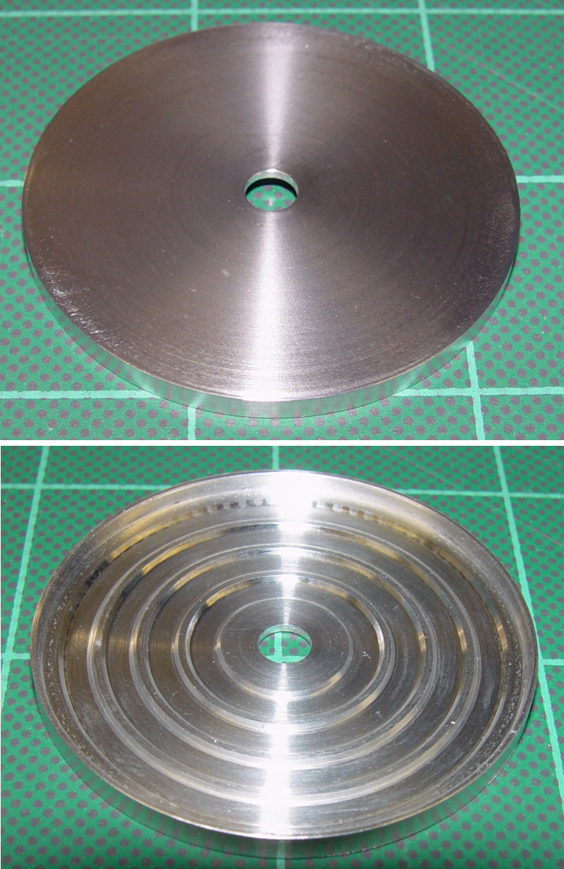

Really not a problem to make a thin metal cup. Nothing would adhere really well to UHMW but I guess some tape could work for a single shot, yes. The advantage of a metal cup would be to remove some stress from the plastic plug. It could be tear at the slot angles I'm afraid, in particular when the plug exist the barrel and the petals separate. A cup would protect from that stress nicely. I'm going to try to make a thin and rigid one with some grooving (groovy!) and see how much it weight. If it's a few grams I'll cut a recess in the plug for it and maybe make it less thick.

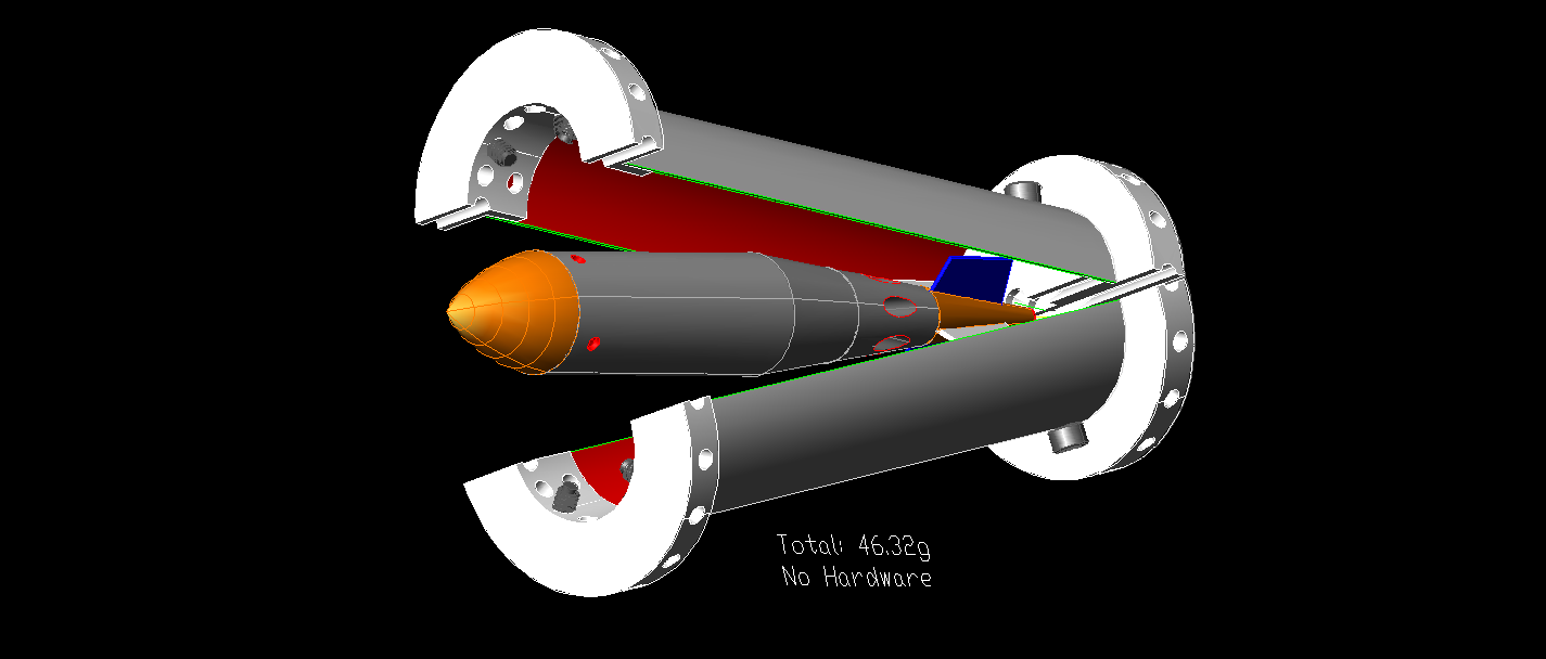

I needed to find out what the specific gravity is for the UHMW that you had.
I was using .95 based on typical specifications but yours is about .934.
The CAD program will calculate volume for me so that I can derive the weight for the individual pieces.
I got my version of "hinged" sabot down to about 39 grams with out hardware. Note the 4 detents and pins to hold MiniBoy.
edit: got it down to 39 grams by enlarging holes from the original 46.

I got my version of "hinged" sabot down to about 46 grams with out hardware. Note the 4 detents and pins to hold MiniBoy.
Lots of holes... niceeee....

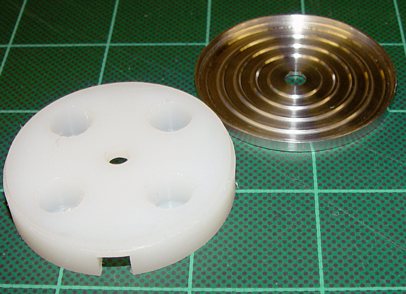

Here's a shiny disc I just finished. Weigth is 4.2 grams. Not bad, it's very rigid, I think I can remove some UHMW.

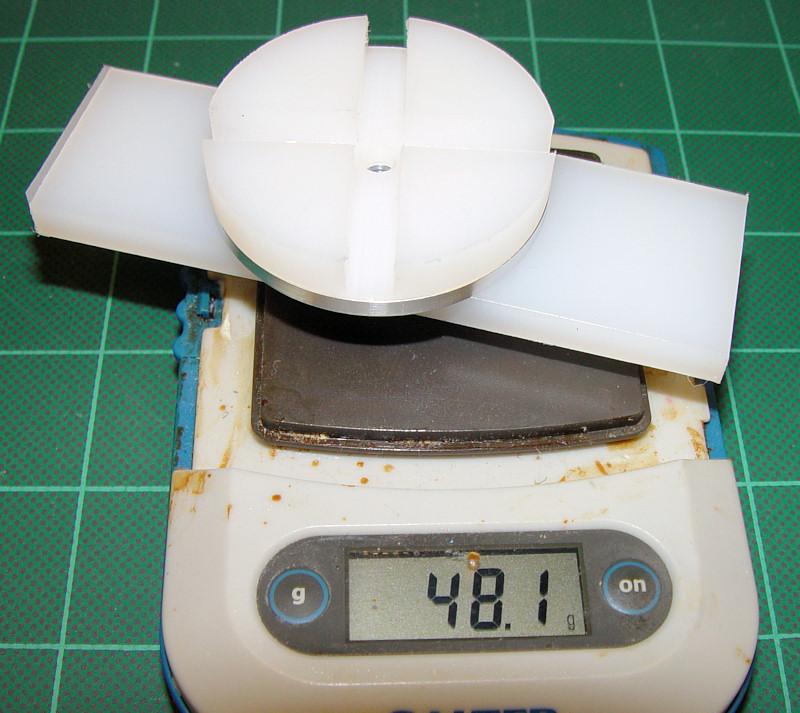

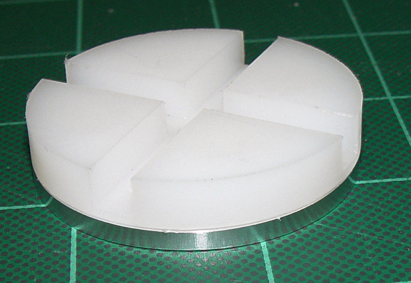

The aluminum plate is fitted to the UHMW plug, and I shaved some weigth while I was at it... minus 5 grams! Yes!!
Sat Apr 30, 2011 6:23 pm
Looking very good indeed.

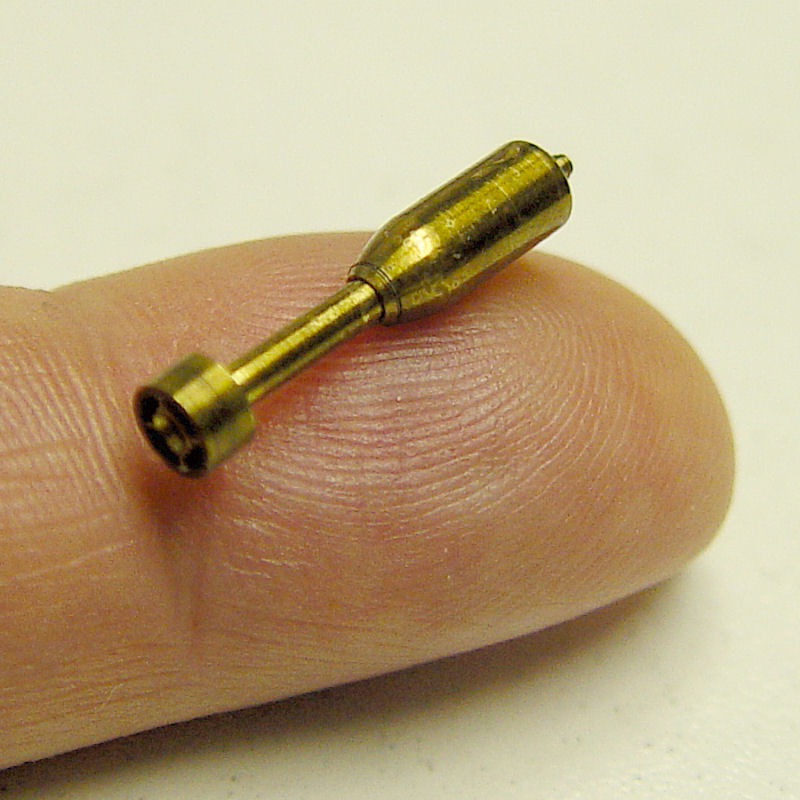

It was retro-rockets fired from Catalina airplanes against Japanese subs during the Pacific war, that had similar fins. It was not a bomb dropped from an airplane, really it was like a rocket.
I did a model 1/35 scale for casting in resin but it was a private commission and I didn't kept anything... except the master :-D

And I found my model in an old box in the meantime :D
