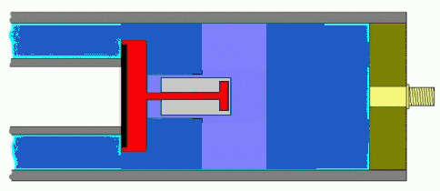

Mon Feb 18, 2008 4:06 pm
here's an animation of my concept:

jackssmirkingrevenge wrote:here's an animation of my concept:
This animation is pretty much spot on for my own design, except the hammer is flat at the front, it has 7.8mm of travel before it should activate. I finished making it today :D
The front part (sealing face) weighs 6grms, the hammer weighs 9grms.
It is pretty sexy too. I am just waiting for the Polyurethane to set so i should be able to try it out this time tomorrow. I'll try a put a pic up this afternoon.
