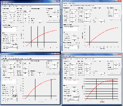

Could you post screenshots, there might be a parameter you're/we're missing.High-PSI wrote:The muzzle velocity goes up with a smaller diameter barrel that is longer (but the same volume). The velocity goes WAY up. Is tha because the air has a straighter shot into the valve?

With a 1 oz. projectile, optimal barrel length is 570" returning a muzzle speed of 573 ft/s. With a 3 oz. projectile, optimal barrel length is 703", returning a muzzle speed of 379 ft/s.
Now, seeing as this information is entirely useless to you, perhaps we should address the more fundamental problem of why you're unable to run GGDT for yourself. Emulators are available in most cases of operating system conflict, or you could run on a computer which already has Windows installed. If you already have a relatively recent version of Windows, it may be that UAC is preventing GGDT from being run. This is usually solved by running the program as an administrator, although at one point I had to disable UAC entirely.
The reason these numbers are useless to you is that you're left with no feel for how performance varies as a function of barrel length. Quite frankly, unless you're trying to make one of those lovely hissing pneumatics the Mythbusters seem so fond of, a chamber as large as you're using is entirely excessive for a 0.625" bore. It would do you much more good to develop a solution allowing you to use GGDT for yourself.
As to the few questions you had: the valve model you're looking for is a barrel sealing piston valve, the dead volume is the valve volume downstream of the valve which is not yet in the barrel, the flow coefficient will be around 40% (I used 45%, but it doesn't make a great deal of difference with excessively long barrels), and the seat diameter is the outer diameter of the pipe the piston seals up against (in the case of a coaxial gun, typically the same as the barrel OD).
I'm also curious as to your propellant gas; pure oxygen is, as a rule, NEVER used in pneumatics, for safety and practicality reasons, and is not even included as a standard gas in GGDT. Using it in the model necessitates entering a bit of additional data - is that where you got hung up?

2"x36" barrel
3/4"x20" chamber
168g Clementine CD close to .6
And
1.68" x 36" barrel
46g golfball CD Of .3
Both at 500 psi and 300 psi
Valve:
valve type - generic
# of valves - 1
Flow Coef. - 5
Seat Diam - 0.75 in
Open Time - 20 ms
Dwell Time - 999 ms
Dead Vol - 1 in3
Thanks in advance for the help

I put 5 and 40 for the flow coef becuase I don't think you really mean 5...
- Lockednloaded
- Staff Sergeant
- Posts: 1566
- Location: Texas, USA
- Been thanked: 7 times
Thanks GunFreak, I think I just copied and pasted that info from somewhere else, but it was supposed to be a 3/4" QEV
