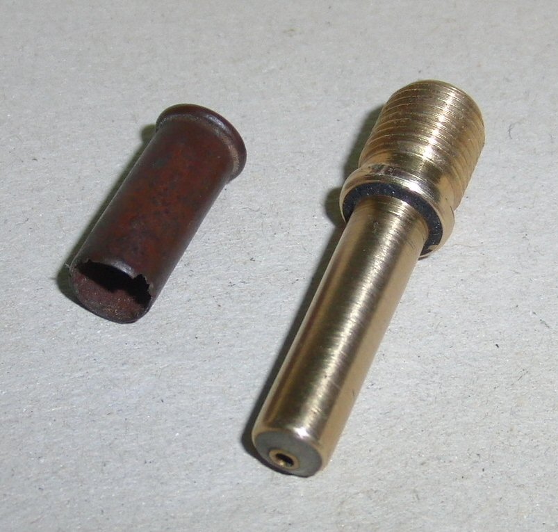

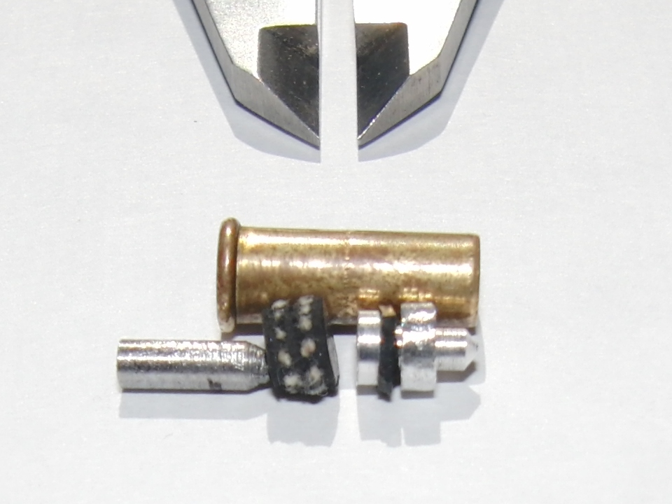

You're making a mini that fits into a 22LR casing?!
Yep. You need to build one inside a presta valve now. Then I will be out of small objects to build inside.
I swear, I lost almost every internal part in the swarf pile on my lathe. Unfortunately, it will have a barrel and chamber around 0.1" long once I'm done, and I only have access to 150 PSI, so I will have a very hard time determining if it shot or not.

Jesus christ, Jack you have some competition. How will you top that?
It has to work first
not to sound pessimistic but it doesn't look like it will.
How do you plan on filling this thing, locking it in a pressurised chamber? Will there be a spring between the fill valve and the piston?
One word of advice, on the pico-ax, the piston is cut out of a section of bicycle inner tube, so it practically functions like a diaphragm valve.

Good advice, and as I said, the last one didn't work. That picture is actually of the original, which I will refer as failed prototype 1 (FP-1 for short).
the new one is actually lubricated, and the sealing surface of the barrel is smoother. The new one has about .1" of barrel/chamber, the rest is taken up by my ghetto fill valve.
No spring in the fill valve, I was trying to replicate a presta. It SHOULD fill with a schrader chuck . My last one had the pin stick out too far, so I had to modify the air chuck. We'll see how this works, but if not, it gives me an excuse to go shooting. I'll run out at FP 600-ish, then go buy more ammo.
