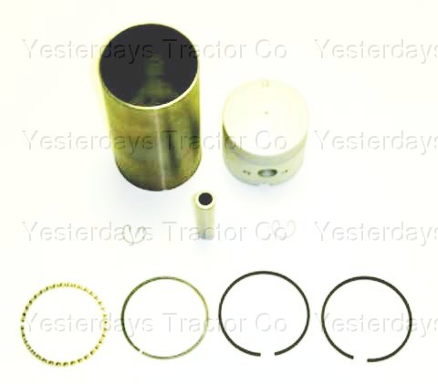

THE COMBUSTION CHAMBER WILL NEVER BREAK FROM PRESSURE EVEN ON NITROUS OXIDE (OXIDISER)
NOTE MANY ENGINES CYLINDERS ARE THIN ALUMINUM WITH A REALLY THIN LAYER OF NICASIL

- HELL OF A LOT WEAKER THAN SCH 40 STEEL
- wm_8N-PK.jpg (28.41 KiB) Viewed 4037 times

wait aren't engine cylinders encased in an engine block, which is pretty damn thick as I recal, or is the fact I haven't slept in two days messing with my mind?
