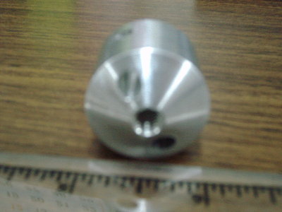

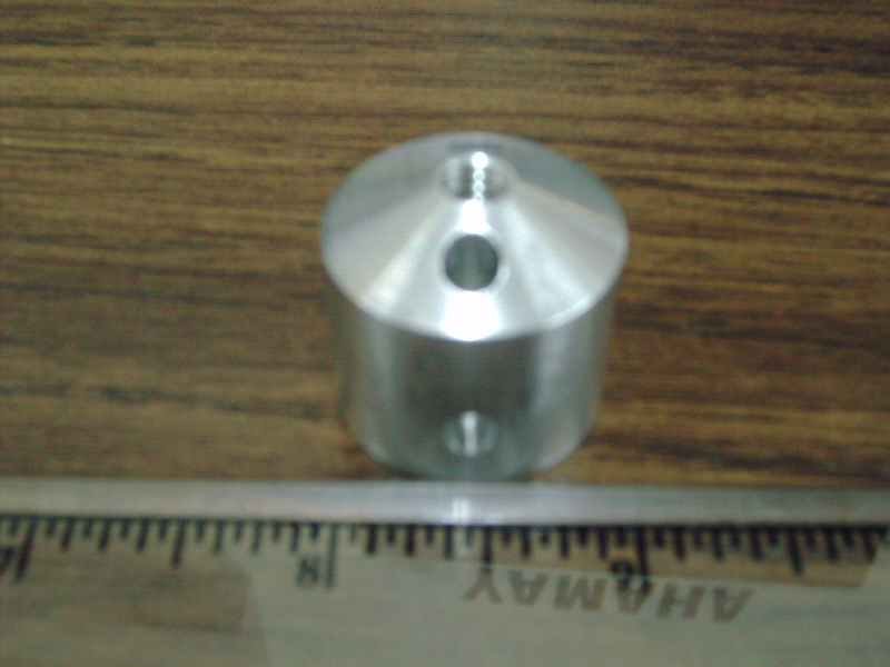

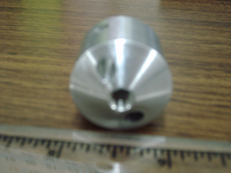

Here's some poor cell-phone pics, I thought I could at least give a teaser while I'm still here at work--Last day of the year for me though! Woohoo!
edit #3--poor me, I keep editing my posts, so no-one knows there's something new here!
Design notes:
1.) Rather than the "notched" rotor that JSR initially envisioned, I went with the design as shown. I am afraid it might cause some feeding issues, but it will be much easier to seal well.
2.) If I do have feeding issues, I am thinking of creating a "ramp" (elongating the opening) toward the cylinder walls. This would keep a bb from riding on the edge of the rotor and rolling against the wall. (in theory)
3.) I'm curious if Delrin could be machined to a tighter seal and accomplish the same end-goal. I might have to play with that while I am on vacation next week.....
--Scott

The rotor design looks good, my one concern would be burst fire, I had envisioned when I first came up with the idea that when the notch would be in line with the barrel, it would be covered so only one BB at a time would come out. All you'd need is a pin really that would obstruct further flow of BBs when the notch is in the "firing" position, without blocking off the airflow.
With your design this isn't possible as more than one BB will gather in the rotor channels, so pending the revs per minute I'd say a double feed is definitely a potential issue.
DAMN YOU JSR!!!!!!!!With your design this isn't possible as more than one BB will gather in the rotor channels, so pending the revs per minute I'd say a double feed is definitely a potential issue.
You cursed me!
Double feed is more than an issue, it jammed up and killed my pretty little aluminum rotor! It might be recoverable, but it won't seal near as well after polishing out the gouge.
Damn I need a lathe, I could keep prototyping without depending on others!
So....if I scrap this and go with a small rotor with a notch, how do I go about drilling a hole within a 1" chamber to place a pin over the firing position? My dentist likes me, but I don't think he'll loan me his right angle drill!!
