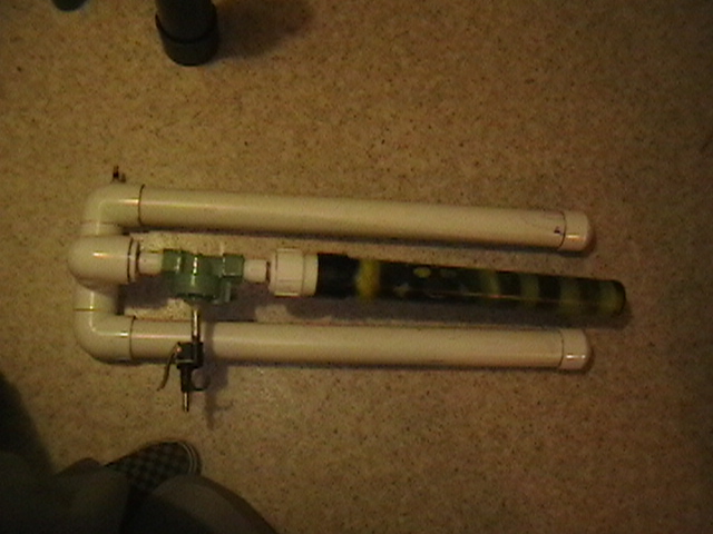

Okay, there have been some horrible stories about pneumatics blowing up. This isn't one of those stories. My cannon is all 2" sch40, with a 1" modified sprinkler valve, set to fit all the barrels from my combustions.
Today the cement had finished curing on my new/first pneumatic, so I went out and bought a new BELL brand bike pump. I pumped my gun up twice to 20psi, twice to 40psi, twice to 60psi, it fired a barrel full of water great... then while pumping up to 80, an explosion followed immediately by chest pain. The pump exploded and shot the rammer into my chest knocking the wind out of me. Luckily it was bought at walmart and will be returned asap...
On another note, I'm using a modified sprinkler valve, and whenever I go to recharge, the diaphragm is not resetting easily, it takes fast pumping to 20psi to get it to set correctly. Anyone have any suggestions? ... the spring is in place properly...

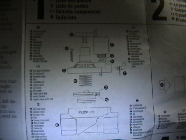

Yeah, there is a big a55 spring in the sprinkler valve that presses against the diaphragm. When I modded the valve I removed the top plate to avoid accidentally dremeling the diaphragm, I then discovered the spring... here is a pic of the diagram from the valves box... the valve doesnt have the flow adjuster like the diagram shows... see figure D for the spring... and yes it is inside
"<I>For dare to be peace, I have to keep at it everyday, da Man doesn't take days off so neither can I</I>" -<B>Bob Marley</B>, day before a performance, a day after being shot in the chest. "<I>If you are the big, big tree, we are the small axe, ready to cut you down!</I>" -Bob again :brave:
Maybe get the spring out, pull at it so it becomes longer, not too hard, but hard enough to deform it permanently a little.
The streched spring will now act out more force when put back in.
But be careful, stretch it too much and it becomes useless.
