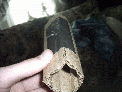

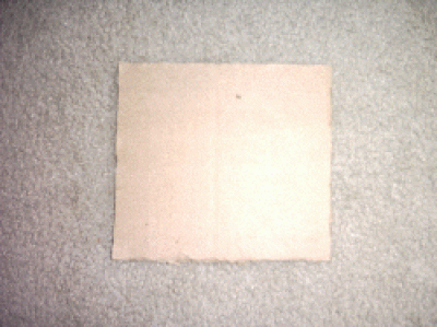

MAIN BODY<br />First cut out a 6”long 6”wide piece of cardboard
MAIN BODY
Then roll or fold in all the cresses in the cardboard and then roll in to a cylinder and duck tape it together.

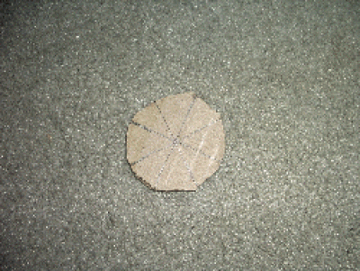

BASE<br />Next is to make the base to hold the sabot together<br />First make eight 1 7/8” lines intersecting at a central point and then cutting along the “imaginary” circumference line to make a circle.
BASE

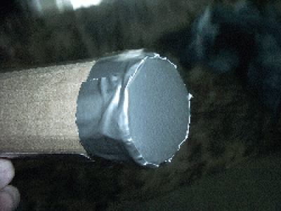

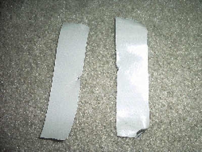

And put duck tape on either side of the disk and put it on one end of the main body and fold over the remaining tape onto the main body. Then take a strip of duck tape and cut it lengthwise.
Then using these strips of tape put them over the overlapping tape from the base to look like this.

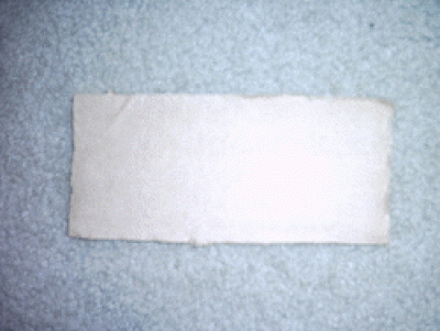

SABOT RING<br />Next is the ring to hold the sabot together during storage.<br />First cut a strip of cardbourd7 ¾”(or 7 ½”) long and 2” wide.
SABOT RING
And fold along the cardboard’s cresses as done with the main body and then fold into cylinder and duck tape it.

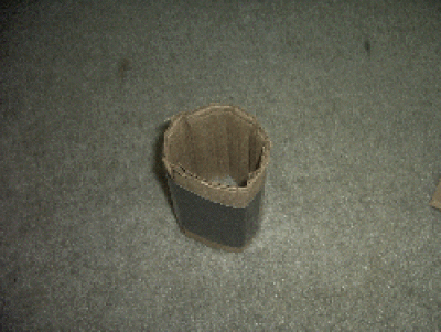

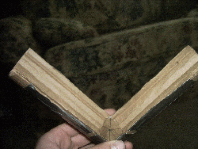

PUTTING IT TOGETHER<br />For the main body cut the cylinder along the duck tape used to hold it together and the tape at the base then cut again on the other side then hold the base so the sabot looks like this.
PUTTING IT TOGETHER
