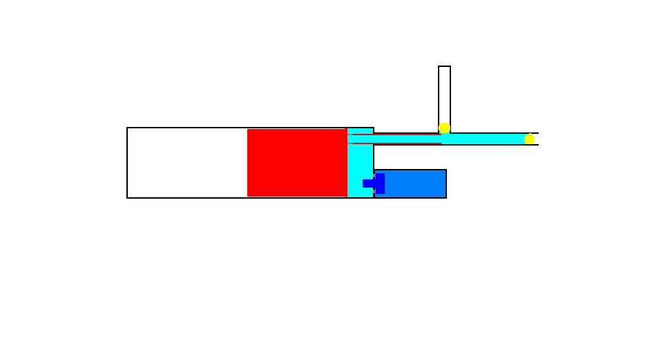

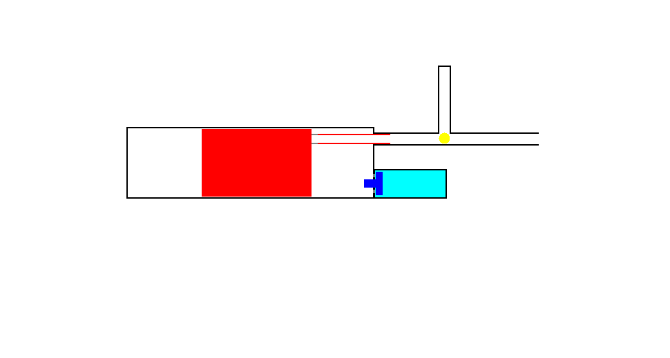

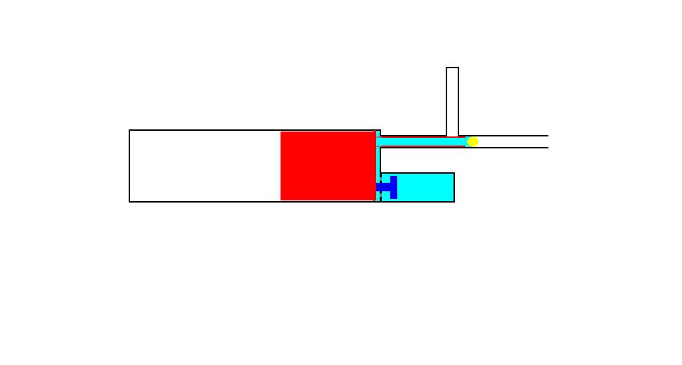

Well after some revising on my current blowback mechanism, I decided to re design it. It ended up closer to a real blowback mechanism (think uzi, mp40, thompson..)
This design now does not require it to be housed within a tee, and gives a breech mechanism to select the round pre firing, so air wont be wasted in the magazine (also a non airtight magazine can now be used). And more efficiency.
The only real difficulty will be arranging the valve/springs/air pressure so that the bolt will cycle far enough forward to isolate the magazine, far enough back to load another round and have a hard enough spring to open the hammer valve.
I have begun construction on this mechanism, but I do need to get pipe that slides within my barrel (telescoping) and find a suitable bolt and housing.
I'll let the pictures explain it.

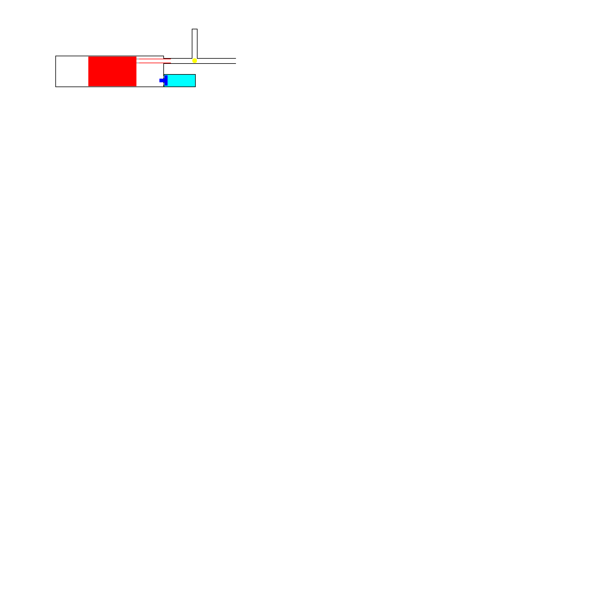

Edit: added animation, hopefully it works..

- The bolt is propelled back by the air, and the round is fired. Once it has returned far enough another round from the magazine is selected and the process will repeat.
- blowback stage 3.PNG (10.87 KiB) Viewed 4345 times
- The breech has selected and loaded a round. The bolt has just depressed the hammer valve, allowing a burst of air into the chamber. Air has begun propelling the round.
- blowback stage 2.PNG (10.96 KiB) Viewed 4345 times
- The bolt is returning to the valve now. On the way it selects a round from the magazine and moves it forwards. The bolt is being propelled by a spring, which is not shown in this diagram.
- blowback stage 1.PNG (10.49 KiB) Viewed 4345 times
- Blowback
- blowback.gif (10.64 KiB) Viewed 4336 times
Looking good if you can make it
one thing I'd worry about is the asymetric pressure on the hammer when it hits the valve that might cause jams.

That's a very good point. So, if I centralized the hammer to the piston it would reduce the chance of a jam?jackssmirkingrevenge wrote:Looking good if you can make itone thing I'd worry about is the asymetric pressure on the hammer when it hits the valve that might cause jams.

From what I understand, the technical name for your design is an "open-bolt" design, where the bolt is held back until the trigger is pulled. Then the bolt would go forward and fire the round.
The only problem I can see with your design is that I am unsure if the bolt would fully return after each shot, otherwise all the air would just go out of the barrel.

PaulsAirsoftArmory wrote: The only problem I can see with your design is that I am unsure if the bolt would fully return after each shot, otherwise all the air would just go out of the barrel.
Technically the air cannot escape until the bolt is out of its housing, at which point the chamber empties through the barrel and the piston can return.
