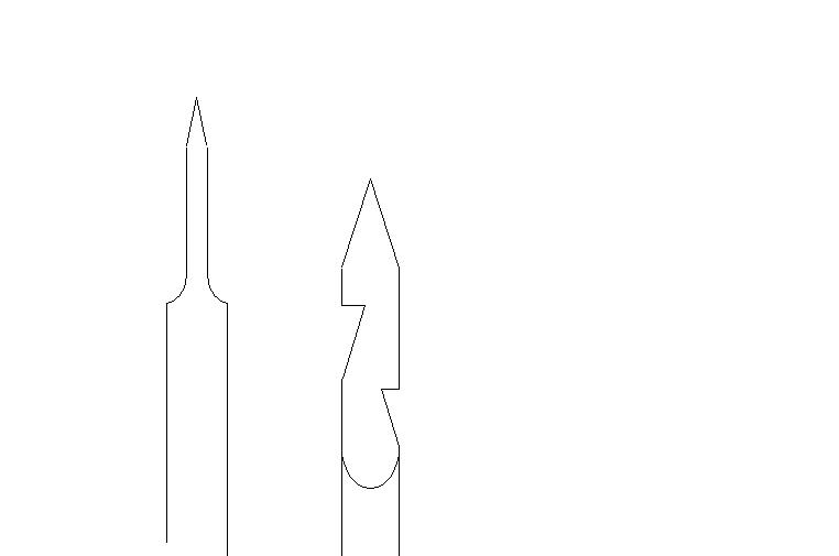

john bunsenburner wrote:One concern I have is th angle of the barb to the shaft, it is fairly large and i am scared it may recuse penetration, remember these will be fired from about 1meter, and no more, and underwater.
I will try another kind of barb and will post it if it works. The sling will also be made better, this one is very crude, and be posted.
Yeh Rob, one concern that I had first :lol: sure, go ahead and steal the credit, I don't mind :D
Be sure to post pictures of barb design #3, since #2 I gave you didn't work out so well :roll:
(proposed barb design 2 pictured below)
Hell I'll come up with a better one for ya, just give me a while to come up with something even you can do :wink:
