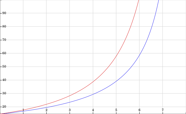

Mon Jan 21, 2013 8:30 pm
Since I deemed that any thermal effects would have been negligible, if any at all, I chose not to use one that equated thermal effects, as this would have unnecessarily confused matters.
I'm not sure you understand what adiabatic means. Adiabatic means there is no heat gain or loss in the process - by definition the "thermal effects are negligible". By using the isothermal equation, you are assuming that the thermal effects are substantial.
I've attached a graph of the difference between the two scenarios. These are both pressure as functions of the plunger position. The blue line is the isothermal equation, while the red line is the adiabatic equation. There is a very substantial difference. It is, however, a very simple fix (and definitely not one that is unnecessarily confusing).
In column AE, instead of using:
='Input Values'!I$13/(AD8+'Input Values'!I$9+AC8)
Which means "APC/(Volume of plunger tube + Dead space + Volume of Barrel)"
Just use:
='Input Values'$D$30*('Input Values'$I$10/(AD8+'Input Values'!I$9+AC8))^1.4
Which means 'Atmospheric Pressure * (Original Volume/Current Volume)^1.4
btrettel
Posts: 383
Joined: Sun Feb 03, 2008 4:40 pm
Tue Jan 22, 2013 7:55 am
Split's right. Isothermal is demonstrably wrong even in simple cases. The higher the compression ratio, the worse the isothermal assumption is. Still, isothermal is okay if you are just getting started, but it should be corrected. I myself wrote an isothermal springer simulation back in late 2008, and by 2010 I had a fairly solid grasp of all the basic physics and was writing simulators just as good (if not better in some regards) as GGDT.
Also, to be clear, the effects of shocks (which include more than potentially heating) are different from adiabatic compression. Adiabatic compression is far simpler to model, involving only the simple change Split detailed above for this simulator. Shocks require at least a 1d CFD model to get right with any reasonable accuracy. As far as I know, DYI, D_Hall, and myself are the only people to consider this. I have not been satisfied with my own simulators that include these physics for various reasons.
For a more complex simulator where the barrel pressure differs from the plunger tube pressure (which is an important effect), you'll need to track the mass flow rate between the two chambers. By doing that correctly you'll also have an adiabatic simulator. GGDT works this way.

Also what could be worth considering is forming a design programme that is made entirely from experimental data, have you ever considered such an idea yourself?
In theory it should yield results which have a very close accuracy, bearing in mind the amount of variables for a spring gun, these results could be as accurate as, if not more accurate than a good design programme.
Also just as a side note, with the velocities that we are talking about, I wouldn't say a 20% error is exactly small, although you are probably right, at the current my programme is quite inaccurate, although as I said earlier, it is a rough estimate
I did some experiments with pneumatic guns back in 2010 that I'm going to use to validate my next few models, so hopefully we'll finally have a computer model with less fudge factors in the next year.
I look forward to seeing it! although it might take some of the novelty away from making my own, that is if it's still worth improving my own, ;)
