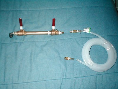

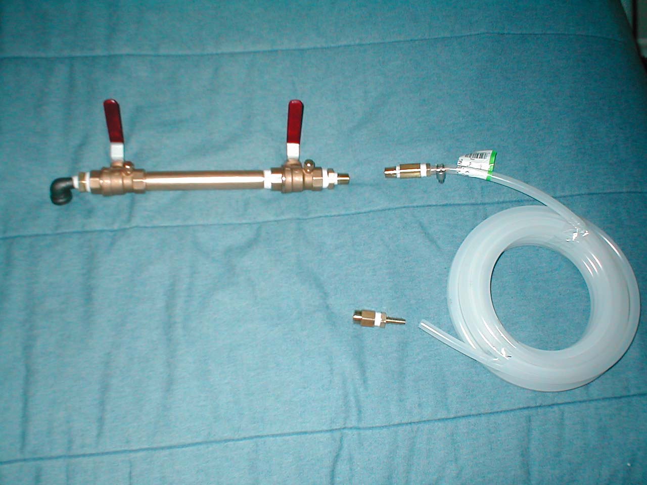

Can someone look over my propane meter to make sure its good
I just assembled my first propane meter, it is missing a couple parts are the moment until i get to a plumbing supply store, home depo doesnt carry tap and die or regulators, the order of parts for the meter is
1. propane torch head not yet cut or threaded
2. 1/8 " to 1/4" female female bushing
3. 1/4 " male to 1/4" barb
4. Polyethylene tubing 3/8 outside diameter 1/4 inside. i think the box said it was rated at 200 someodd psi i hope it wasnt in the wrong box. But its pretty thick so i imagine its right.
5. 1/4" male to 1/4" barb
6. 1/4" to 1/4 " nipple
7. 1/4" to 1/4" adapter
8. Regulator not yet bought (i really hope it has a 1/4 female thread when i buy it)
9. 1/4" to 1/4" nipple
10. 1/4" to 1/2" bushing
11. 1/2" Ball valve
12. 6" L 1/2" W meter pipe/nipple
13. 1/2" Ball valve
14. 1/4" to 1/2" bushing
15. 1/4" male to 1/4" female 90 degree street elbow
16. 1/4" to 1/4" nipple
Note all fittings are teflon coated, 5 layers and tight as hell. (probably need a vise to get them apart without ripping my palms off)
I just want to make sure everything is safely put together and is correct before i start rigging it to a gun.
Thanks.

it looks nice and shiny.
i wanted to make one of those portable propane meters like on advancedspuds.com but i never got to it.
i started building pnuematics
finished one yesterday in fact, launched a soda bottle over 100 yards with it. can't wait to get my hands on a digital camera and post it.
the meter looks really nice can we see the gun?

there is no gun yet lol...but since i love gorts blue flame design so much im gonna use that shape... props gort its beatiful. Im just using a lantern sparker instead of stun gun because stun guns scare me... i was hesitant to see what it felt like to shock myself with my bbq, god knows what the stun gun can do to ya. Basically, i was not planning on that thing costing me 70 dollars to make... i was thinkin ok 40 tops... and i would be pipe but my reciept was a shitload more lol. And i still need to buy a chasing die and regulator which is like 20 dollars. Joels meter pipe is definately priced correctly for his site, sadly its the only thing he sells that is not overpriced.
						Nice, Polyethylene should be rated to about 300psi so your fine... Looks great...
Good thing you didn't get Vinyl tubing, that's only rated to about 55psi
You probably could have made it for cheaper, but it's a pain in the ass looking for all the parts, sorry if my directions to make it were shitty from ealier

Well not ALL regulators have 1/4" ports, but most do. The only reason I say anything is that I would hate for you to buy one only to find out it's a 3/8" or something.
