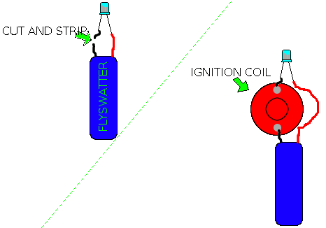

With the LED, you're basically using the gap between the two anvil posts as a very small spark gap... so I guess my question here is why not fashion a small spark gap that's adjustable and with replaceable parts? Not trying to be snide or anything, just curious.
Also, here's a simple modification you can do with your current rig that I think you will enjoy thoroughly.

Mark that's exactly how it works.
However, i don't have an ignition coil in hand right now, I only have two flyback transformer i used to build a plasma speaker.
I tried to hook them up to the flyswatter and well, it works, but i get a 4 inch spark and i get a little shock every time. The electric field is so intense that everything ferrous around aligns itself on the field lines. (some left over iron dust was on the ground of my room and jumped as i activated the circuit.)
I think what you're suggesting is to transform this basic setup into a sparkgap switch to trigger a much bigger spark between interchangeable electrodes. (A stungun per say)
This might very well work but as I said, I don't have a step-up transformer suitable for this design.
I might add that current might flow back in the flyswatter circuit, unless I use a Fast diode rated at the required voltage.

CpTn_lAw wrote:However, i don't have an ignition coil in hand right now, I only have two flyback transformer i used to build a plasma speaker.
I think I just got a semi.
EDIT:
You could try wiring a simple 1n4001-7 diode in parallel with the load (coil) with the cathode positive as a flyback diode and seeing what happens. You can find rectifier diodes like that in pretty much any power circuit (CFL bulbs have them in the base).CpTn_lAw wrote:This might very well work but as I said, I don't have a step-up transformer suitable for this design.
You got a semi? Didn't get that one.
I have a few 4007 diodes from the plasma speaker circuit.
I could have just built a simple 2n3055 + flyback igniter... but I already knew it worked so I wanted to try something else.
I just did a blank fire with a simple alimentary film burst disc. I forgot how loud this thing is... A 6L combustion with 2" barrel.
It ignites on the first try. I use syringe metering from a butane/propane bottle.
