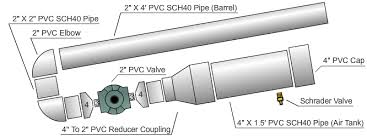

I am a new user and would like to find some simple plans for a tennis ball launcher/cannon that I can build with my teenage kids. The launcher/cannon will be used in a midway-type game where the balls are shot at targets about 30 ft away. Launcher/cannon does not need to be high pressure or overly accurate. I have an air compressor that I can use. Can anyone help?

A quick Google will give you plenty of plans.
For tennis balls you need 2.5 inch PVC which can be hard to find sometimes, but can also be ordered.
I recommend a simple solenoid valve to act as a dump valve (there are millions of sources on this online).
Alternatively you could use a regular ball valve, but it won't give you near as good performance, and will be hard to use for target shooting.
You could do something like this, but with the proper barrel size.
