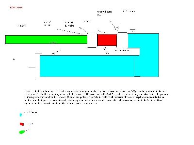

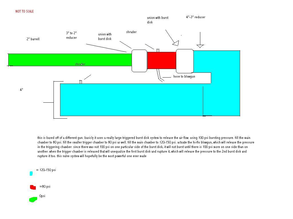

they have 3" sch80 unions at my hardware store, and i think im am going to buy them ill post plans in a few mins

Problem with that daveo, is that the disk will burst before the other valve is compleatly open.
I'd look into triggered burstdisks (look it up on the spudwiki). (technicaly a cascade failure burstdisk system, I think)
thats what i posted...............
						yes you do, you are able to fill the chamber to 100 psi, but you first must put 50 psi in the 2nd chamber this equalizes the pressure and lets you use more.
						- boilingleadbath
 - Staff Sergeant 2
 - Posts: 1635
 - Location: Pennsylvania, USA
...unless you where to put a pressure regulator between the chamber and the "pilot volume"... with a flow restrictor.
