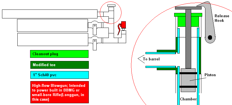

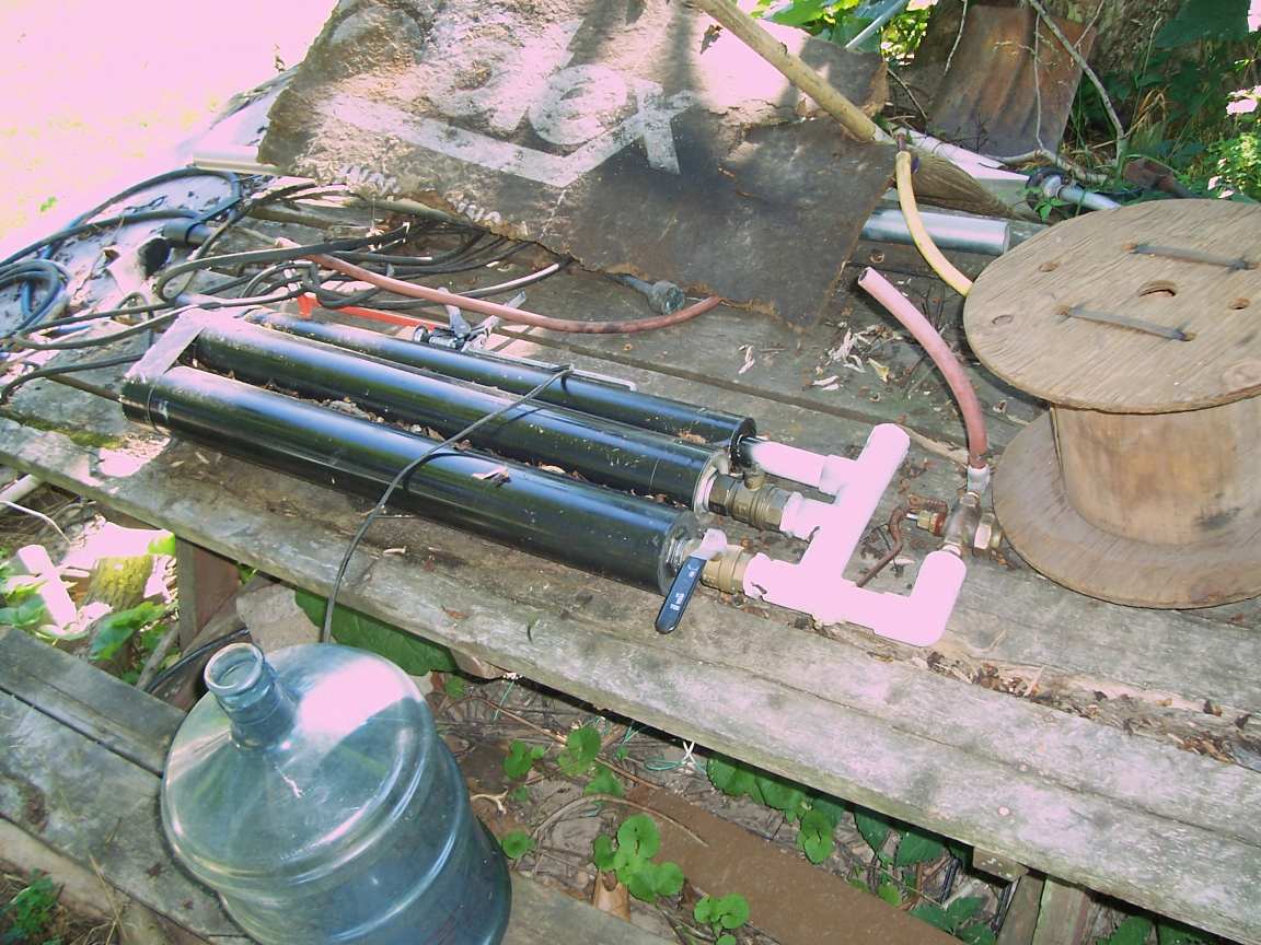

Couldn't you use one big chamber, one small secondary chamber, and maybe a regulator?
OR
You could try making self contained cartridges. neither of these ideas are really new concepts though.
I have an unfinished gun sitting on my pinic table that uses the same concept, though it's a bit bigger. I was going to enter it in the competition but I figured I'd have a better chance of getting the hybrid done in time.
(I'll post pictures if you really want me too... kinda lazy right now).
Ok, I posted it, but the colors are a little funky.
Rather than explaining everthing in this post, I made a diagram showing the basic setup and how the valve works.
And before anyone asks, this gun uses custom pvc plugs instead of 3" endcaps.
Here's the diagram, also unfinished. It should give you a general idea of how it works.
