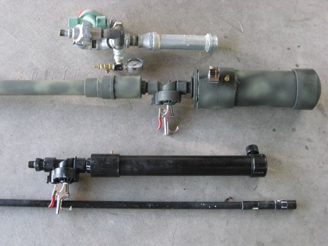

This is my last gun I bought parts for in America, it completes my American Spudgun stock pile :P
All three guns I've made with American parts are relatvily simple and basic, that's what I was going for again because I feel like having some reliable, multi-purpose guns I can bunt around with without worrying too much about them.
This one is similar to the <A HREF="http://www.spudfiles.com/forums/viewtop ... 90">SGI</a> in terms of design.
It borrows my <A HREF="http://www.spudfiles.com/forums/viewtop ... 16">SGA</a> golfball barrel for the time being.
I also had three almost empty cans of spray paint, hence the quick camo job where I just layered all the colours on over about 15minutes.
Specs:
Barrel: 40mm PVC PN18 Golfball Barrel/15mm PVC PN18 Paintball Barrel
Chamber: 100mm PVC PN18 Chamber.
Valve: 25mm/1" Blowgun Modded Sprinkler Valve
Guage: 0-260PSI
Fill Valve: Schrader
Operating Pressures: 60-115psi

T-Shirt Barrel, was originally my 80mm DWV chamber from my very first combustion, which I decided did better as a T-Shirt barrel, so I cut it up and glued on a spare 2" threaded adapter.
I tape up old T-Shirts so they don't come apart when fired and they seem to go around about 60m at 70psi and have quite a bit of kick.

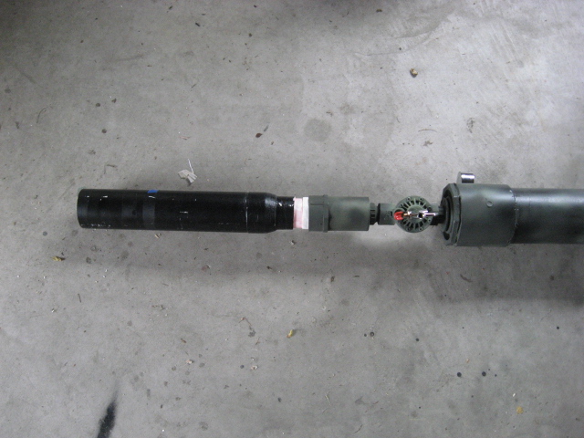

Over View
Over View
Over View.JPG (39.86 KiB) Viewed 6246 times

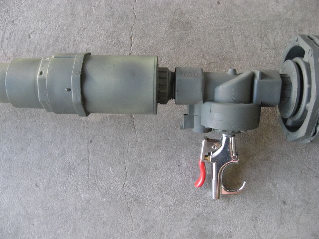

Down Sight
Down Sight

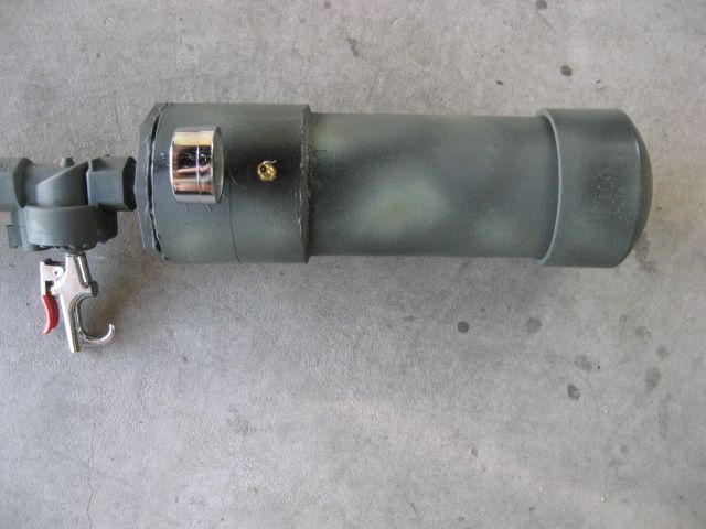

Chamber
Chamber
Sprinkler Valve
Sprinkler Valve

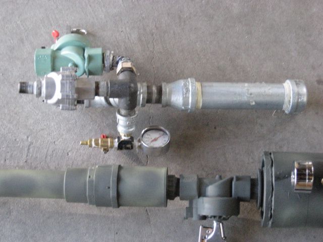

American Spudgun Stockpile

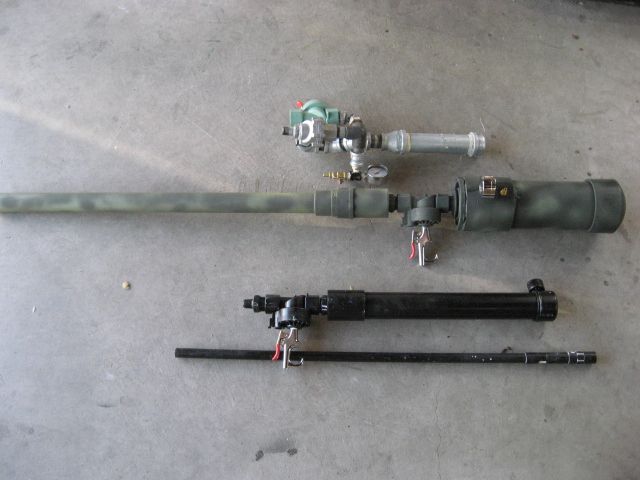

All Three American Spudguns

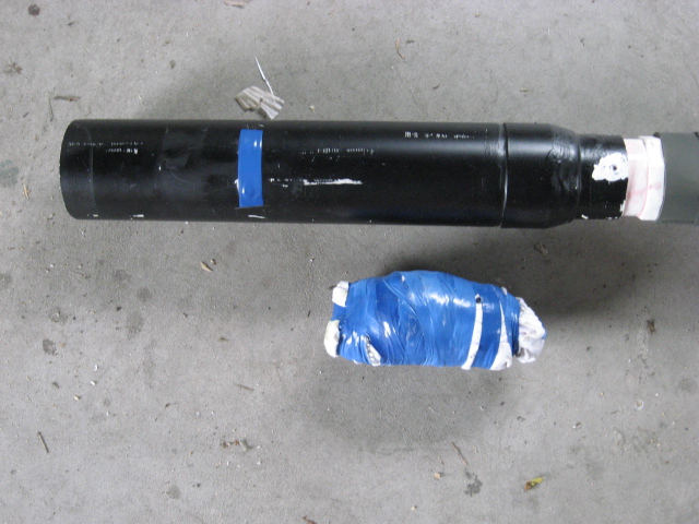

T-Shirt and Barrel
T-Shirt and Barrel
T-Shirt Barrel
T-Shirt Barrel

Thanks, 115psi is. My compressor goes to 115psi, and I can't be bothered taking my 120psi pump up to 120psi with that chamber for an extra 5psi.
