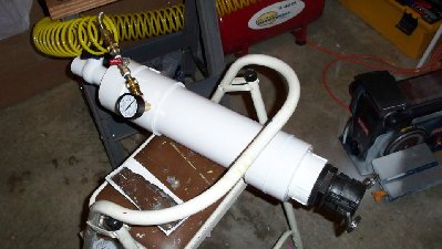

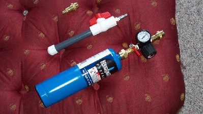

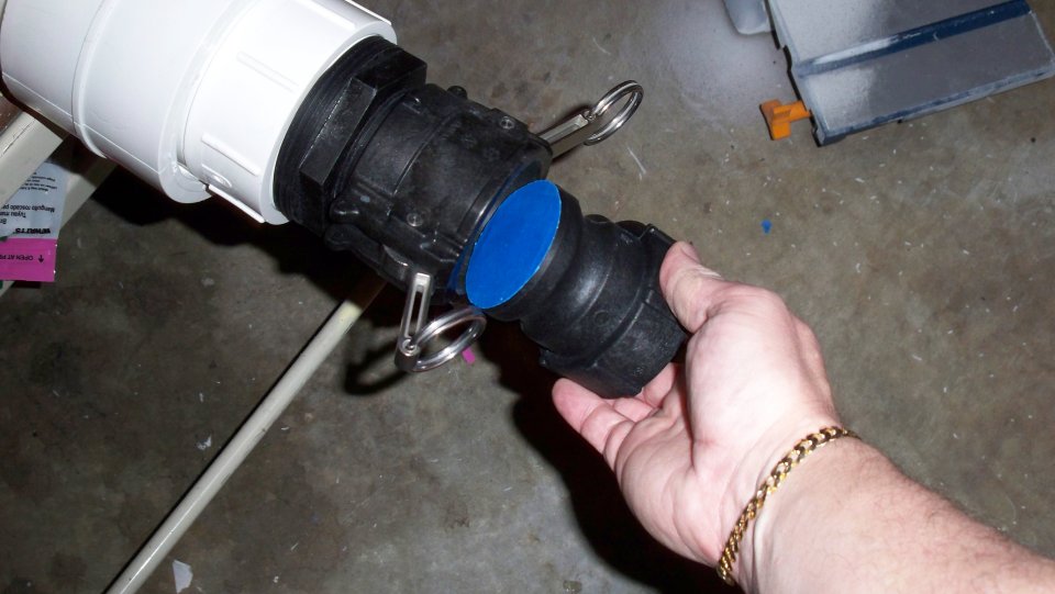

I'm doing the same thing for my Summer gigs. However, I'm building 4 combustion units to attempt to keep up with pace of the 1812. An ear-protected operator with be reloading the quad-battery with pre-measured syringes of propane and pre-built burst disk barrel stumps.
I will be firing remotely in time with the music.
This thing is immensely loud!

In my situation (not sure about Rcman's) there will typically be fireworks and a general expectation from the crowd for that sort of thing. The bigger the boom and display, the better.THUNDERLORD wrote:Like I explained, as soon as it goes boom and they find out it it uses combustion, It's a pyrotechnic ie: BOMB.
Being a public gathering and with that type music there are sure to be many kooky people there.
You could get the same effect w/ pneumatic by using a large chamber into a small diameter pipe then into a large diameter pipe. But even then you should make it as short as possible so if anything flies out of it, it won't have much velocity but still have Boom effect.
Also, while a pneumatic can be loud as well, it has more of a loud "snap" or "crack" sound rather than "BOOM" report....and no cool blue flame propagating out if it...
Don't worry, I take crowd safety very seriously. They will be shot from a safe distance and no projectiles will be involved....except maybe some blue masking tape bits.....

That unit I show there basically becomes a pneumatic with the back ball valve closed and burst disk installed. That's how I've done most of my disk testing. I wear ear protection when shooting it pneumatically...it's way loud. It just misses having the same reverberating boom as it has during a combustion blast.THUNDERLORD wrote: I think it would be interesting to see someone design a pneumatic for that
using a burst disc (like Starman's combustion version)and a smaller barrel into a larger one.
I have used only 80 psi disks however...the most I dare do with a 1x combustion. A higher psi disk would I'm sure have a somewhat louder report on a pneumatic, just not sure it would have the boom I want.
