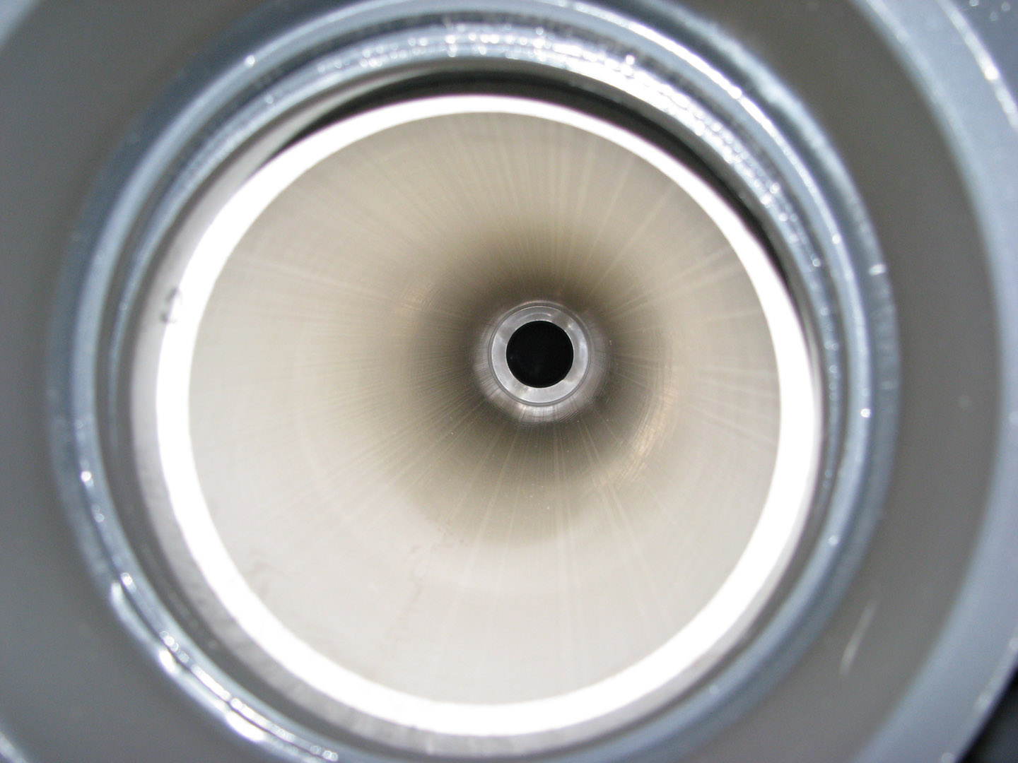

Down the chamber, from the flange.

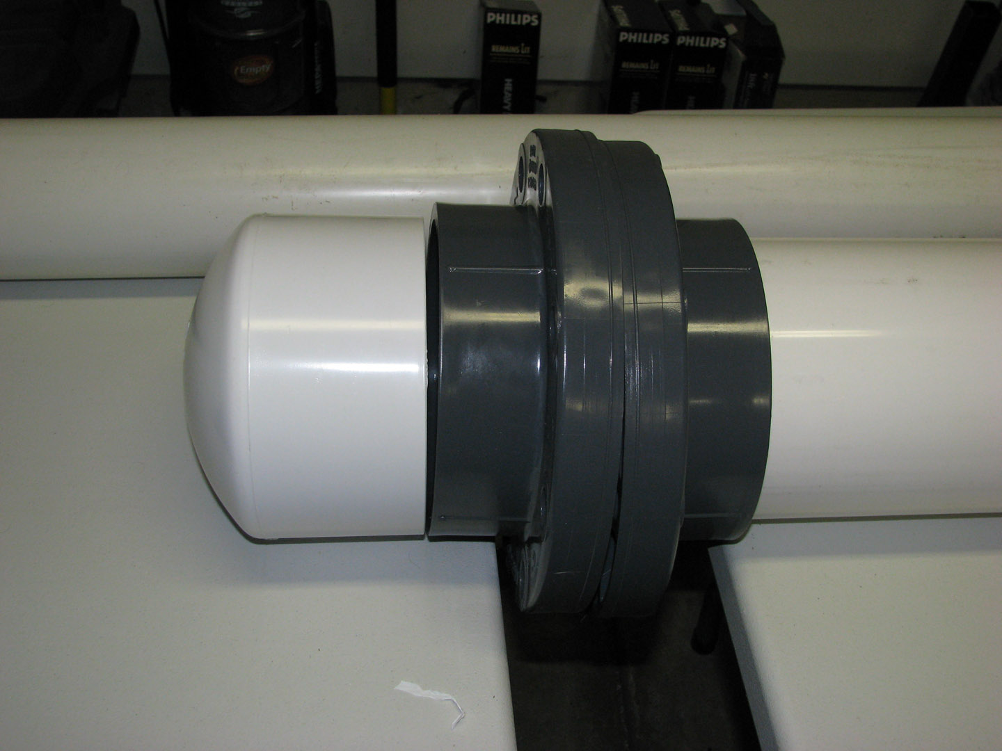

The end of the chamber.  So far, using flanges is the most economical method I've found to plug up the end of the chamber.  Since it's 6" ID, I plan on making a nice sliding spark strip that can be easily serviced without jamming my arm down the chamber.  I have lots of room, might as well take advantage of it!

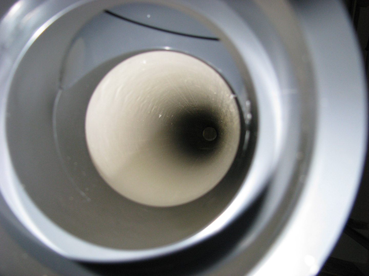

Down the barrel, from the breech.
