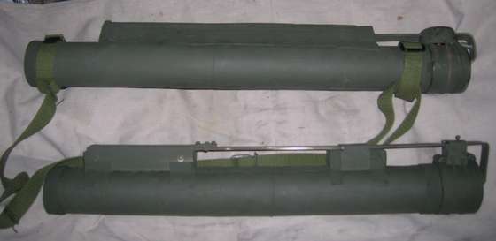

ok guys im really excited. I just secured an inert m72 law tube to use for airsoft. For those of you who don't know what an m72 is....
So now its time to start figuring out how to get it working but i really don't know where to start. It needs to use the 12g co2 cartridges to power it and i would prefer to have it fire when the button on top is pushed.
After all the genius stuff i have seen built on this website i figured this would be the best place to ask advice. Any and all ideas are extremely appreciated. THanks!

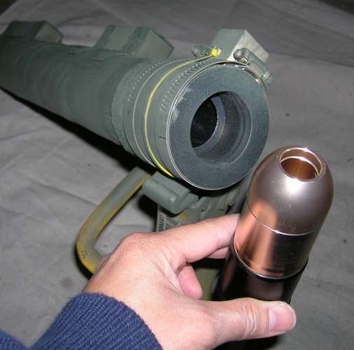

if i had a m72 tube i would fit an airsoft m203 grenade it, that would take care of the chamber and valve all in one shot. somethig like this.

wow, that's pretty impressive grumpy. nice find . link?

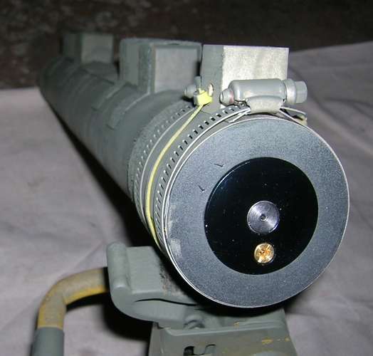

ok i finally had some time to work on this project but its a lot harder than i thought it would be. I only have 22 in. of space to work with and 2" fittings do not fit inside the tube.
Both the toolies valve and coax set up are giving me problems because i do not have enough room for a schrader valve for filling and another valve for releasing the pilot on the back due to a lack of a solid end cap. The trigger has also become an issue because it needs to still fold up. However, the actual trigger could be used to pull something back about an inch.
Just out of curiosity would a presta valve work for filling and have enough flow to be the exhaust on a 2" outer and 1" inner coax?
