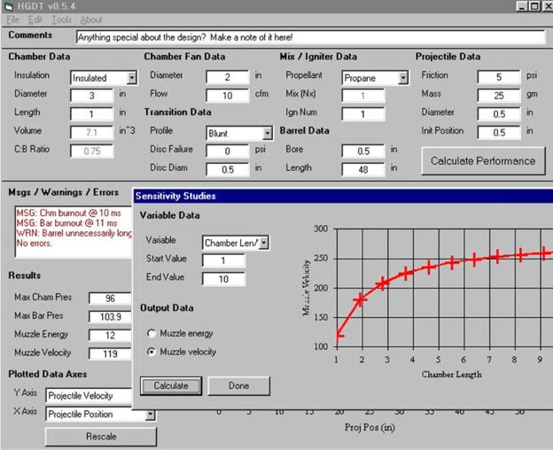

Easiest thing to do is enter your barrel, fuel, spark and ammo parameters into HGDT and do a sensitivity study on the chamber length starting with a convenient chamber diameter. There is a good chance you'll find the "optimal" chamber is impractically large, so decide what an acceptable trade off is between performance and practicality.

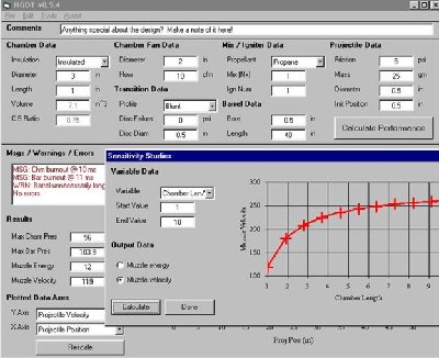

Attached is a HGDT study for a 0.5"x48" barrel assuming a 25g shell and 3" ID chamber. The CB 0.8 gun has a 1.1" long chamber. A CB 2 gun greatly outperforms the CB 0.8 gun, ~200FPS vs. ~130FPS. Larger CBs are even better. If you change the ammo mass or friction the results will change significantly. It's up to the builder to decide where the best tradeoff is between performance and chamber length.

Sun Jul 06, 2008 12:54 pm
if i were you i would just hgdt it cause it would be easier to use and you would not have to wait for replies. although it can be wrong some times it is usually pretty accurate. personally i would work out the formulas by hand but thats just me. anyways jimmy101 is correct so just listen to him.
