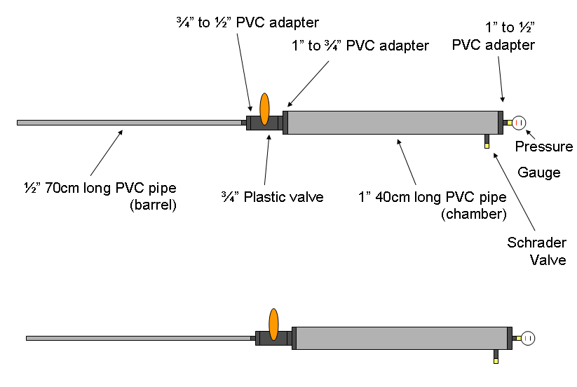

These are my plans for the gun:
(I'm gonna take it up to 100 psi, I hope it won't explode!)
Tell me if it looks good!
The plans.
The plans.
My newest plans.PNG (21.92 KiB) Viewed 2664 times
Ragnarok
Posts: 5401
Location: The UK
Mon Oct 13, 2008 10:43 am
That will work, although a better valve choice would be a 3/4" sprinkler valve if you can find it - even an electrically operated one, although not ideal*, will provide a lot heap power than a ball valve, but not be hugely more complex to set up.
Eventually you'll be grateful you did, it'll be more worth keeping.
*In an ideal world, you'd mod it for blowgun operation, but not everyone wants to do that.

starman
Sergeant Major
Sergeant Major
Posts: 3027
Location: Simpsonville, SC
Mon Oct 13, 2008 10:52 am
It won't explode.
This should work fine. You could get by with 35 cm of tank if you wanted. That would still give you a 2:1 c:b ratio and would be plenty for marble shooting.
Also, the pressure gage on the end is not recommended. One of the first things you'll want to do is stand the gun up on its butt....goodbye gage. You could build a tee configuration with your schrader and include your gage there...just cap off the back.
elad311
Posts: 94
Joined: Sat Oct 04, 2008 7:48 am
Mon Oct 13, 2008 10:58 am
starman wrote:Also, the pressure gage on the end is not recommended. One of the first things you'll want to do is stand gun up on its butt....goodbye gage. You could build a tee configuration with your schrader and include your gage there...just cap off the back.
so, Should I screw a regular cap in the end, and put the gauge near the schrader?

starman
Sergeant Major
Sergeant Major
Posts: 3027
Tue Oct 14, 2008 1:09 am
Or just a cemented cap. Tap one 1/4" NPT hole where you show the schrader and install a tee through 2 layers of PVC. On one connection of the tee install the schrader, the other install the pressure gage.
Hydra
Posts: 131
Joined: Sat Mar 08, 2008 11:58 pm
Location: New South Wales, Australia
Tue Oct 14, 2008 4:01 am
If you want, you can make that T come out more with a little bit of pipe to make a small stock.
Make it so the end of the chamber looks like a w. The schrader and gauge are both pointing forwards (on the side of the T) and the long, bottom part of the T has nothing on it (except some end caps) so you can use it as a stock.
elad311
Posts: 94
Tue Oct 14, 2008 4:26 am
can you draw it for me?
I didn't understand..
